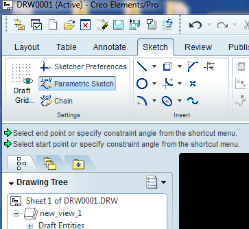

I have a few basic (I think) questions - A part on which I am working requires a certain area to be left with an as-machined finish while the rest is brushed. On the detail drawing I am trying to add a dashed line parallel to the part to indicate the as-machined region. However:
  1. While I can sketch a line on the drawing, I cannot find a way to add constraints to make the sketched line parallel to the part.
  2. Furthermore, when I try to dimension from the part to the line, the dimensions are driven. Thus there is no direct way to control the length of the line. Even if I get it close to the right length by dragging the ends of the line around, the dimension displays the exact value for the line length, not the exact value I want. It will not let me override the dimension to display the value I want.
  3. I would also like a way to dimension from the part to the line to lock it in the right position with respect to the view, but then hide the dimension so that it does not show up on the drawing.
Any tips on how to do these things?

Hi Jeff, there are a couple of tools that might be of use to you. Try parametric sketching, here, the system remembers parametic sketch references, so addressing point number 1. Try "relate to view" to address point 3. I am not sure what version you are using, but in Creo/Elements 5, this can be found under 'Edit, Relate, Relate to View'.
Hope this helps
John
December 23, 2014
Jeff,
You can do the first thing on your list but that's about it. When sketching the line you first need to select snapping references, in this case choose a line on the drawing that you want to use as the parallel ref. The parallel constraint should be added automatically once you sketch the line close to parallel with the ref.
The other two, you're probably out of luck unfortunately; you can use 'relate to view' to lock it to the view, but without being able to create a driving dimension to position it accurately, there's not too much point in that.
I will add my voice to those above, the best thing to do is to forget about trying to do any sort of accurate sketching in the drawing environment and use cosmetic sketches in the model. Every time a new version of ProE/Creo has been released, I've hoped for some development of the drawing environment but a lot of the deep issues are still there.

I just tried the model sketches combined with using layers - what a relief! That gets me where I need to go. Of course it would be more convenient to work directly on the detail drawing, but it is a way to at least get the information on the drawing. Thank you to all who provided advice!
