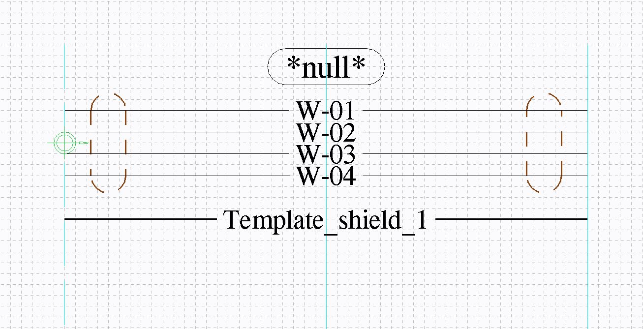

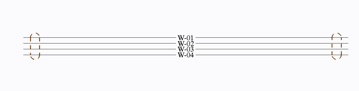

I've made a custom cable, and I've added a label to, it should show the part number of the cable, however if I route the cable the label is not there, it doesn't appear at all. What should I do?

Firstly you will need to upgrade to Creo Schematics 3.0 M020
In the catalog explorer open the cable shape, select the cable decoration, and add the label.
Your label will then appear when you place the cable and will move with the cable decoration
See the attached movie

How can I get the update? Currently I have the M010 version. After updating Is it possible to add the label to the cable itself (see on photo) not to the decoration?

You can download M020 from the software update page https://support.ptc.com/appserver/common/login/ssl/login.jsp?dest=%2Fappserver%2Fcs%2Fsoftware_update%2Fswupdate.jsp&msg…
The label has to be attached to the decoration
