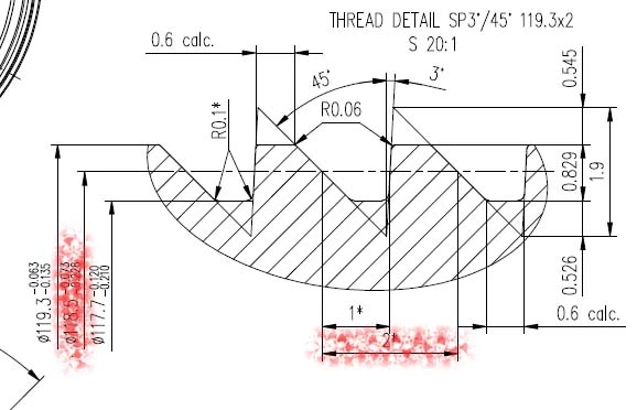

i want to make drawing on creo 2 showing the dimension of pitch, pitch diameter and other like the attached picture . thanks

all dimensions of thread can be display just the pitch , and pitch diameter , please need a help

thanks Mr TomD.inPDX but my problem not for creating thread for 3d model , my problem how to display annotations of the pitch and the pitch diameter in drawing ( 2D )
thanks again
waiting your help
* i attached drawing and the required annotations marked with a red color

the attached file(*.drw) show what i want to do , there is easy way but i cant not remember
