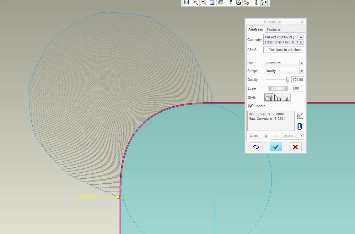

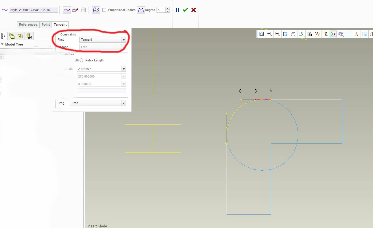

Hi Bernie, that is the exact method I am using. My issues are these though.
You can choose between curvature or tangent of the end point. If you switch control points on (when you are editing the ISDX curve next to where you choose number of degrees) you get even more control. I attached a screen shot to help explain. I can only move points B and C independantly if the ends are tangent, if the ends are curvature B and C move together. When I look at the curvature graph (shown in a screen grab) and I keep the points at default but flip between curvature and tangent I see no difference. If I move point B closer to point C when the end is tangent I get a nicer curvature analysis (it gradually decreses to zero) on the ends. What I find strange is that this is a characteristic of a C2 curve but I can only achieve this with tangent ends not curvature ones?

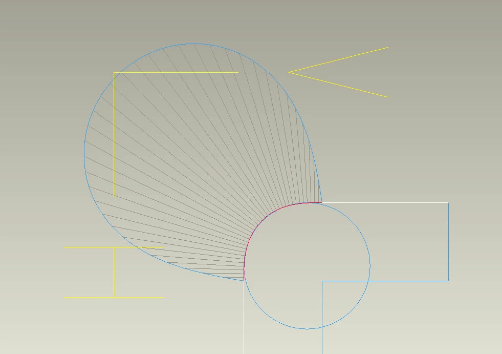

Another issue I am having is that when I extrude this curve my curvature analysis gets messed up. It looks stepped and the ends no longer go to zero (see screenshot). This happens if I copy the curve too. Basically whatever I do to that curve loses it's nice curvature.
Any ideas on this?!

Racheal,
For this, I would refer you back to Greg's comments. I think what your
seeing is intended functionality. I can't speak for right or wrong, but
rather, it is what it is and (as far as I can remember) has always been. I
think it just boils down to the math that controls Tangency conditions vs
Curvature conditions.
Then, I will also reference Greg's comments on "Personal Preference".
Personally, I don't mess with the ISDX control points. To me, they just
"muddy the water". I try to keep it as simple as I can and really only mess
with Tangent vs Curvature end control, Trim lengths, and stretch values as
stated in my earlier post. Overall, I have been very happy (and very
successful) with that method.
As for your other issue, (someone please correct me if I'm wrong...) I
don't know that Extrude features have ever been able to maintain Curvature.
IMHO... If I'm working a project that is styled enough that I need to
create Curvature construction features, then its also worth me taking the
time to build proper Boundary surfaces so that I can control all of the
edge conditions.
If I'm working something that is not so styled then I stick to extrudes and
radii. --- or maybe Conic Radii with a Stretch 🙂
