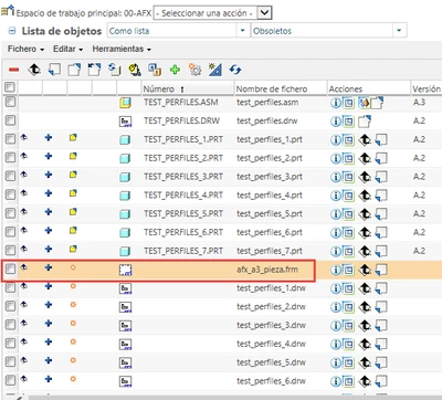

2) When I use the "afx_a3_pieza.frm" format stored in AFX "drawing_formats" folder, AFX can find it, but its created in the Workspace as a New Object, althoug the format exists in Windchill:AFX_new_format.png
Can I configure anything so AFX can find the format in Windchill and reuse it? The only way I have found is to previously donwload the format to the Workspace...

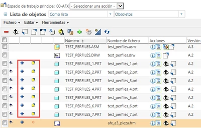

3) When I create the drawings, all profiles are Extracted, althoug they shouln't have been modified...
Is it the intended behaviour?

Best answer by SamuelBrantner
hi @avillena,
in order to make that work you will need to set the following option in configuration/hidden_options.cfg:
DRAWING_FORMAT_PATH <PATH>
Path to drawing formats (e.g. wtpub://Windchill/Libraries/Formats)
This is required, as AFX tries to evaluate the config.pro option pro_format_dir and on the startup the server can not be reached until the user did the login.
Regards Sam

It's working!! Thank you very much!!
