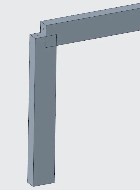

When I insert an aluminium-profil (any Bosch-Profile for example) the profile isn't displayed very detailed:

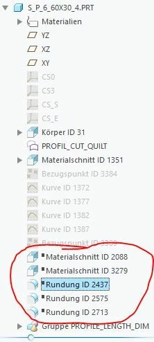

The reason is, that a lot of KEs are suppressed:

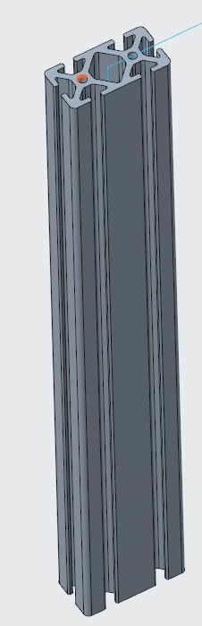

When I activate them, the profile looks very nice:
Now lets assume that I have an assembly with 100 profiles. Is it possible to activate all suppressed features of all profiles (all at once) ? And is it possible to suppress all of them again to get better performance ?

you can find the answer in attached document.
August 1, 2019
SamuelBrantner
August 1, 2019
Hi @MaikTheBike,
also see this chapter in the help for more information:
https://support.ptc.com/help/creo/creo_pma/r6.0/usascii/#page/advanced_framework%2FAbout_AFX_Simplified_Representations.html%23
Greetings Sam
Greetings Sam
August 1, 2019
Thanks. It works perfectly.
