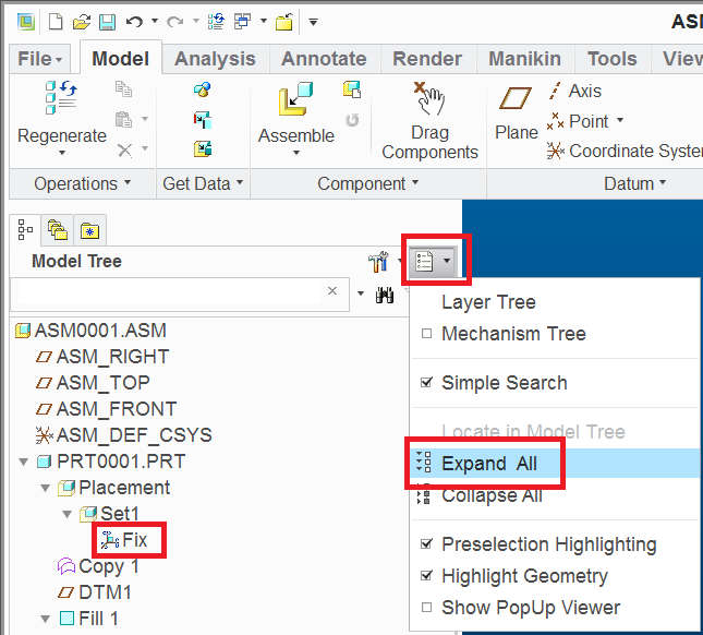

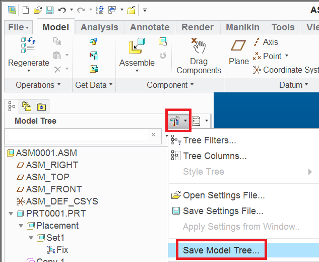

I don't know of a direct way to do it but one method is to use the model tree. (creo 2)
1. Set the model tree to show only placement folders.
2. Expand all on the model tree.
3. Save the model tree (not the settings but the text out)
4. Search the text file for the word "FIX"
You can automate steps 1-3 with a mapkey if you find yourself doing this over and over.
October 9, 2015
Expand All
Save
