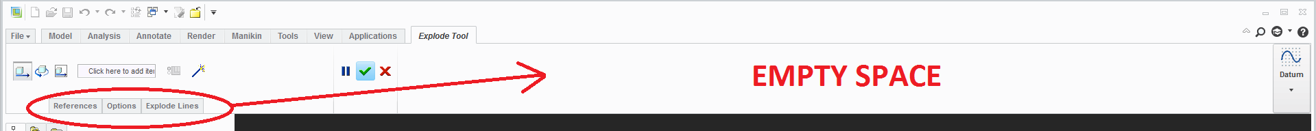

I mostly like what they've done with explode in Creo, though the one thing I can't come to terms with, and that is the layout of the tool itself. On my monitor the explode tools take up only 1/4 to 1/3 of the ribbon space, with most of the tools you use when manipulating the explode hidden under drop-down tabs.
It seems like blind adherence to the ribbon regime; when we moved from WF to Creo there was a lot of hype about the percentage reduction of mouse clicking that we would experiece, and then they go and do stuff like this... There's plenty of space, get the tools out into the open!
I know it's minor thing, but that one has always annoyed me.

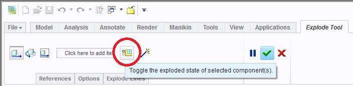

January 27, 2015
In Creo 2.0, you can also select the part/sub-assy, then click this icon. It should look like this. Just make sure you also save the Exploded view in the View Manager (sigh) and also the file.
