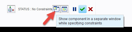

Please does anyone remember how to open a separate part window in an assembly model, A small window for the active part being assembled that comes up on the assembly screen, it helps to make it easy to pick features in a part where their is a cluster in the assembly.

Use this button in the dashboard.
January 12, 2016
January 12, 2016
In the model tab, select assemble, <select the component/assembly>
a new tab will open - component placement
there will be two window icons toward the right side, select the first one.  this will open the component in a seperate window

Thank you all. (Gary, Ron, and Amit). your answers rightly answered my question. I had been playing with it for a while and kind of stumbled on the answer by myself but thank you guys anyway.
