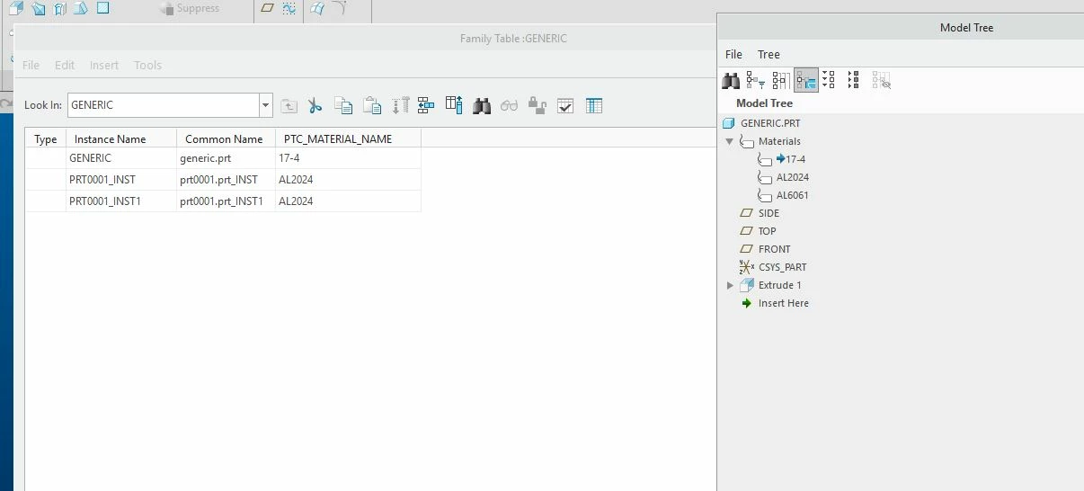

I am trying to assign Material from material library for the instances of a Family Table. Has anyone have idea on this ? Family Table consits of instnaces with different materials. I tried assining density to each instances by using relations and I could create it. Is there a way to assing material from library by using relation to instances of a Family Table?

It would be required to add all the materials (needed to be assigned to different instances) to the generic model,
after that in family table parameter "PTC_MATERIAL_NAME" can be selected & drop down menu for the materials already added to generic is available
