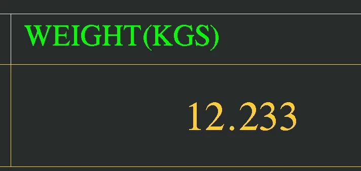

I was successfully able to bring weight in bom,but the weight is showing in three decimal units how do i change it into single digit

if table cell shows value saved in weight parameter (for example), then you can use &weight[.1] notation inside table cell.

That worked ,thank you so much
