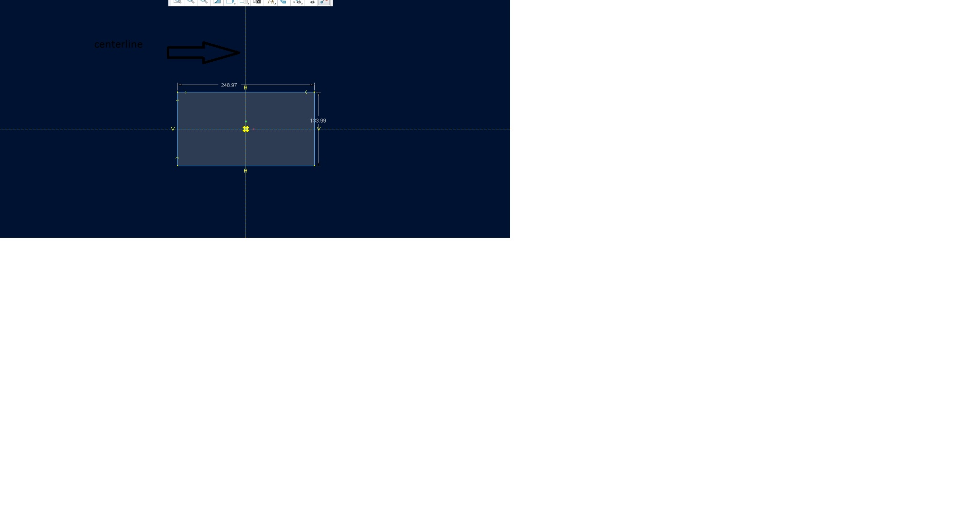

i drawn a rectangle , how i put middle axis (orizontal and vertical) ,
i put in 3d but in 2d not see this
i put axis with sketch but i do not control dimension on it ? it's a tips and tricks for this
tks for response

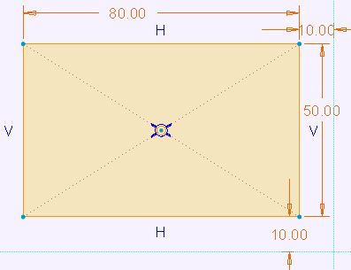

Best answer by kdirth
One method is to put diagonal contruction lines through rectangle in the sketch and place datum point at intersection. When extruded it creates a centerline. this can then be shown in the 2D.

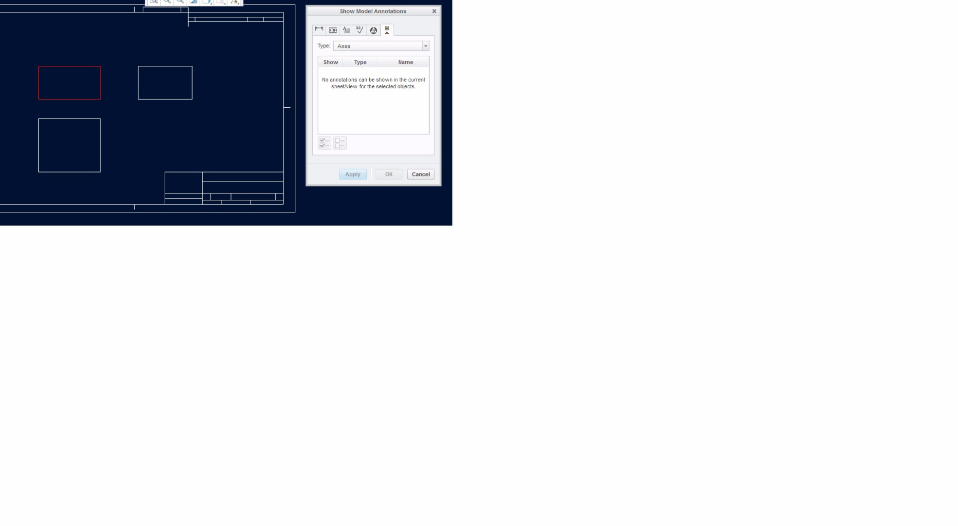

Use 'Show Model Annotations' to show the axis in your drawing (2d). It will be the 'model datums' tab within the Show Model Annotations window.
Redro1-VisitorAuthor
May 11, 2015
i don't find the axis but it is a circle you are right
