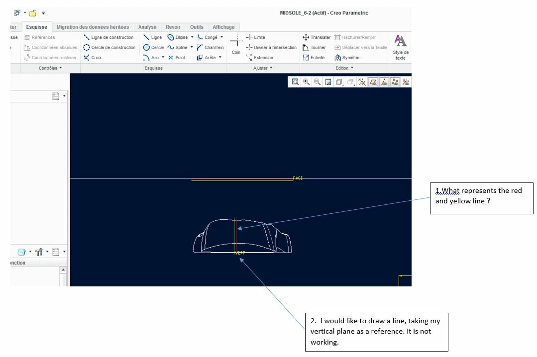

My question is about drawing. It is a basic question, but I can't figure it out :
I made a drawing of a part (so far easy...) :
1. I have enabled the plan view : Why are there a red and yellow line ?
2. I would like to draw a line, taking the plan as a reference : is it possible ?
Thanks a lot for your help,

select the particular plane part
right click and select properties
select either ansi or iso datum
now when you see the plane in drawing
it will be a single line with the datum symbol
offcourse you still have to hide the planes from the display filters.

that is the datum plane. the front and back of a plane is shown in two different colors.
go to display filters and uncheck the datum planes.

I would like to keep the datum planes on my drawing.
Is it possible to represent the plane by just one color/line ?
March 20, 2015
yes you can by converting it into a model datum
