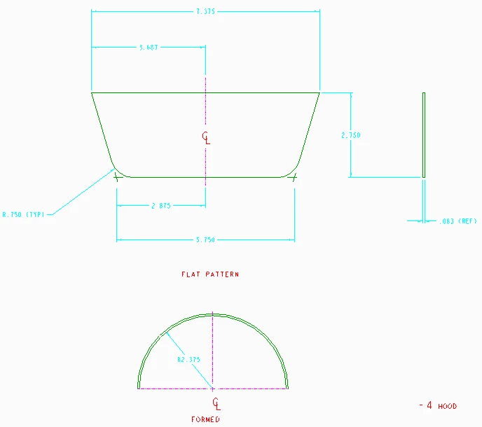

All,
Given the attached drawing. What id the best way to go from flat to formed?
I'd like it to be in sheet metal. I have been given a Toroidal Blend option, which appears to work. But I am wondering if there is a sheet metal option? Bend gets me nowhere.
By the way, I suspect that R given is incorrect and should be doubled?

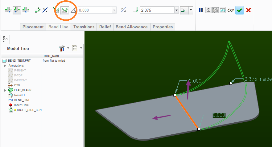

Best answer by psobejko
Try using the "Bend to end of surface" option in the bend tool:
I had to use two bends (bent the left and right side up from the centerline) to get the full form.  There might be a better way to do this with just a single bend.

Maybe unorthodox, but one way would be to start a sheet metal part from scratch, extrude the curved final shape (this would be a simple half cylinder), unbend, cut the profile to match your flat pattern, then bend back. Working with sheet metal my strong preference is to model the final bent part then flatten it rather than starting with the flat and trying to bend it to obtain the final part.
Alternatively, you can sketch your flat and add a bend at one edge selecting to the end of surface, but I don't like working that way.

psobejko1-VisitorAnswer
January 12, 2017

StephenW
January 12, 2017
Oh the bend radius specified is probably correct. Just a quick look at it and the form to flat calculation was very close...it all depends on operations and material.
