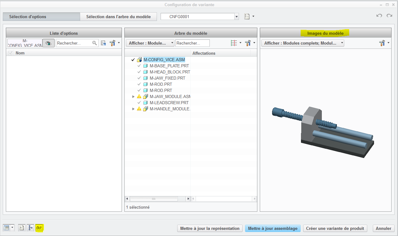

I open the "alternative configuration" feature (the below button), a window opens with 3 parts: options | model tree | graphic preview
when this Window opens, the cache will populate with one "sid... .wfcont" file per part.
when this Window opens WITHOUT the graphic preview, the cache will populate only if I open a configurable module node.
so here is my answer: How can I configure PTC CREO to not show this third part?
or, is there an option to not populate the cache until I do not create my variant?

Best answer by Ronan
I found this config.pro option:
dm_preview_searches_server no
it allows to not download the files for the preview, so the preview is still open, but empty.
Ronan14-AlexandriteAuthorAnswer
July 24, 2015
