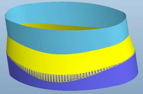

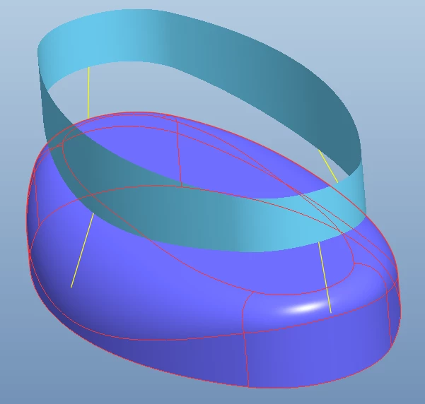

I am looking for suggestions on how to blend tangent from a variable radius to a non-planar edge. The perfect command would be something like "blend edge to surfaces". Sort of like the "blend section to surfaces" command, but to an non-planar edge or curve instead of a planar section . Any ideas? Pictures and step file are attached. The yellow lines show where the surface would be in 4 locations. Thanks.

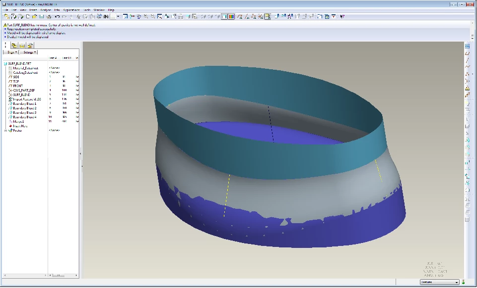

I've attached a Creo 2 model.
[cid:image002.jpg@01CEE058.CD3612E0]
I made a copy of the edge of the edge of the extruded surface (turquoise), and then extended the surface. I then created a surface to surface round, through the curve (copy of the old edge). It wanted to round both the inside and outside, so I had to exclude the inside pieces on the 'Pieces' tab. It then only rounded the ends. I created the middle, longer parts separately after, selecting only an individual curve segment rather than the entire curve as I did at first. It did generate several geom checks, which I didn't investigate.
I did not try to merge it together, that may prove challenging as well. I'd start by merging the 4 round surfaces, then merge it to the upper then to the lower.

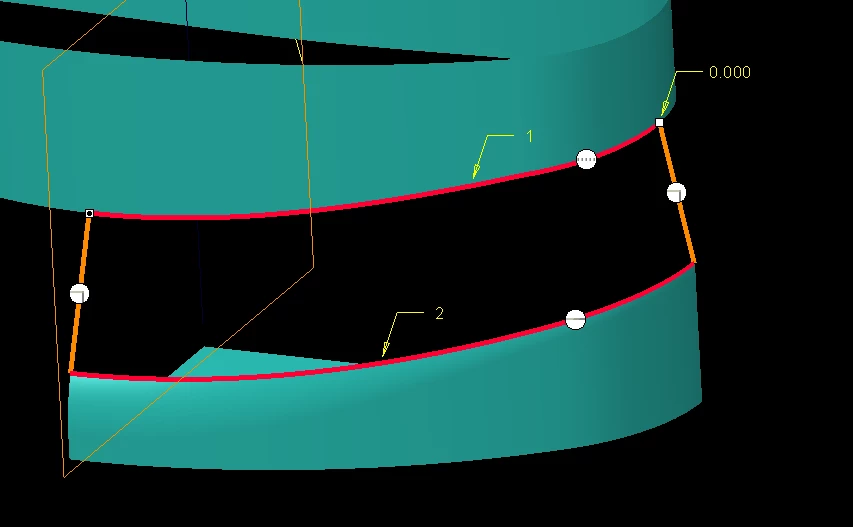

I created 4 curves thru points, making each end of each curve tangent to the vertical surfaces (top and bottom) then built a boundary blend curve using the bottom edges of the top surface and the edges of the variable round as my first direction curves with the 4 curves thru points as my second direction curves. I set the boundary blend border conditions to Tangent (top and bottom edges) and got the results below

Hi
I did something similar with boundary blends however, I didn't bother with
the curves. I just used the two surface edge curves (top and bottom) and
set tangency to the adjacent surface. I tried all the way around in one
feature but that didn't seem to work, so then I did the long sides first
followed by the short curved ends after (four blends in total) and with
the shorter blends I used the long blends side edges as the second
direction curves.

Actually, in this particular case I do NOT want tangency between the spherical surface and the blend. The radius will be added later. The non-tangent edge should set the angle for the tangent, straight-line blend to the variable radius. Something more like this:
[cid:image010.jpg@01CEE061.887FF5E0] [cid:image012.jpg@01CEE061.887FF5E0]
To achieve what you see above I am "faking" the variable radius with a variable section sweep driven by a graph. The graph represents the radius values at the different control points. This "sort of" works for simple, 4 point variable radii, but I would much rather blend to the actual radius without trying to recreate it with a graph. In the pictures above, the "faked" radius is on the left and the actual radius is on the right. As you can see, the tangency isn't quite perfect. (This might be a function of my graph as well - just a spline through points.)

I see now. That's not simple. I've created an approximation, but it's not 100% accurate. Maybe close enough?
I assumed your model was symmetric in both directions and cut it to 1/4 and built that:
[cid:image002.jpg@01CEE065.8DE1B060]
I made 3 sketches through the upper edge and tangent to the lower radius. Two are on the midplanes, the third is on a plane through the arc in the variable fillet. I then made a sketch on the long mid-plane (FRONT) consisting of a 3 point spline through the ends of those sketches and projected it onto the variable radius surfaces. The end of the spline on the RIGHT plane must me constrained to perpendicular to that plane. I then made a boundary blend using those 3 lines, the projected curve and the edge of the upper surface. It's constrained normal at the mid-planes and tangent to the variable radius. I doubt it's a perfect straight section at all points, but it's a close approximation. Adding other intermediate curves and additional spline points might help, but would be difficult to properly orient. Lastly, I merged it all together; it only needs to be mirrored, merged and solidified.
