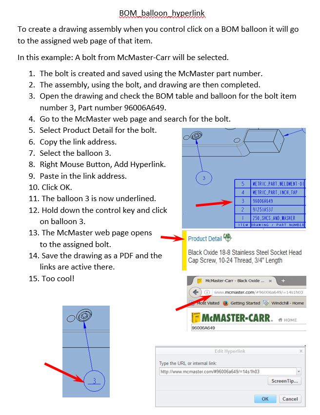

Is there a way to hyperlink a part number in the BOM table? I know how to link notes, but i want to link each part number in the BOM table.

Rocky,
Hyperlink is abailable for notes, as of now not for part number in BOM

Thank you Dan. This was very helpful.
