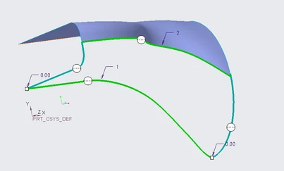

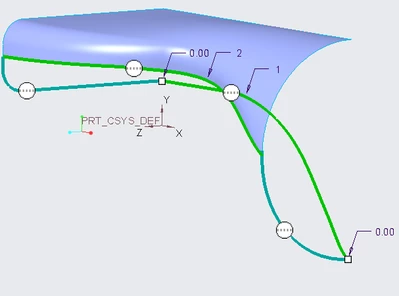

I will start by saying that I am new to Creo 4.0 Parametric. Currently I am trying to model a surface using a boundary blend, but it won't blend properly (notice that isn't showing a preview). Line 1 is a spline on the xy plane, while line 2 is a projection from a line originally on the xy plane onto a extruded plane that is hidden. The secondary bounds are simply a quarter circle and a filleted rectangle. Is anyone aware of why this won't blend? The top surface that is already shown as blended is the exact same (for the most part) except that instead of a spline on the xy plane, a straight line is used. Any help would be greatly appreciated! Thanks in advance.

Can you share the part file?
tstern951-VisitorAuthorAnswer
July 3, 2018
Sorry, no need to at this point. I simply redrew the sketches, followed the same procedure and was able to get the blend. My guess is that it was either a bug or potentially an error with part resolution. Thanks though!
