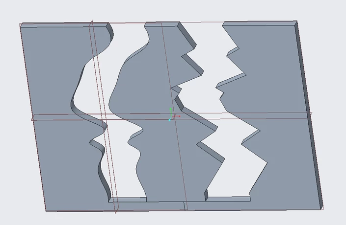

I am trying to make clearance a moving part.  In assembly I used moving part -A- as a reference to give clearance with part -B-.  but I about destroyed my asm when I moved -A- back.  Is there a way to make a part independant and say "ok I dont want to change the way you look but stop using other parts as a reference"?
simple exaple.
block A is 20mm
block B is 30mm taller than block A
I want B to stay at 50mm regardless of what A does.
I dont want to export then import the part just to break references.  there has to be a way to do it in CREO yes?
Best answer by dschenken
Open only part B; don't have the assembly in session.
Redefine the feature in Part B that refers to the Assembly. It will ask if you want to keep or delete the assembly reference. Delete the references.
dschenken1-VisitorAnswer
December 1, 2017
GInserra1-VisitorAuthor
December 3, 2017
I might be over thinking this but im not sure how to do that.
could you give a step by step?
December 4, 2017
yep. I was overthinking it.  after playing around I have it figured out.
