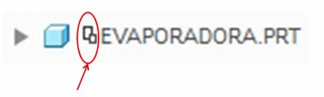

What means a two boxes symbol placed toguether a part (.PRT) in the browse bar ?
See attached image.
I need browse bar symbol list, please.
Thanks in advance.
Best regards.

Best answer by Mahesh_Sharma
@Ed13
That is an indication that this feature is a child of a packaged component.
Check help http://support.ptc.com/help/creo/creo_pma/usascii/#page/fundamentals%2Ffundamentals%2Ffund_six_sub%2FUnderstanding_Glyphs_on_the_Model_Tree.html

@Ed13

Perfect!
So Good So Fast.
Thank you very much.
