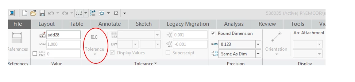

Can anybody help me to solve the tolerance issue in my Creo 4.0 ?
  • May 17, 2019
  • 2 replies
  • 1831 views
Why the tolerance option is disable on some of my drawings ( not on every drawing ) ? I did turn on the tol_display as yes , Still didn't work . I would really appreciate if somebody help me on this ?
Best answer by Mahesh_Sharma
@pobsd
Set drawing option (DTL option ) tol_display as yes
(File > Prepare > Drawing properties > Change detail options)
Mahesh_Sharma
22-Sapphire I
May 17, 2019
@pobsd
pobsd13-AquamarineAuthor
May 17, 2019
Thanks !!
