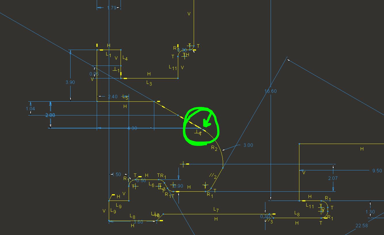

iam unable to extrude my sketch as solid but instead it is extruding as surface. i went through the drawing so many times but couldnt find any open loops.
Iam attaching the file can someone go through that and tell me where it going wrong.
Thanks in advance
Best answer by jmikesell
you have overlapping geometry. An advantage of creating the sketch in the feature/extrude is you will get an error when you try to complete it. You don't get this in the sketch only. See below for where the extra line was.
I would recommend breaking this up into a few sketches, extrude the outer shape and then extrude the t-slots, etc. trying to cram a bunch into one sketch becomes unmanageable at some point.

Yes you have an extra little line under  another larger one.
