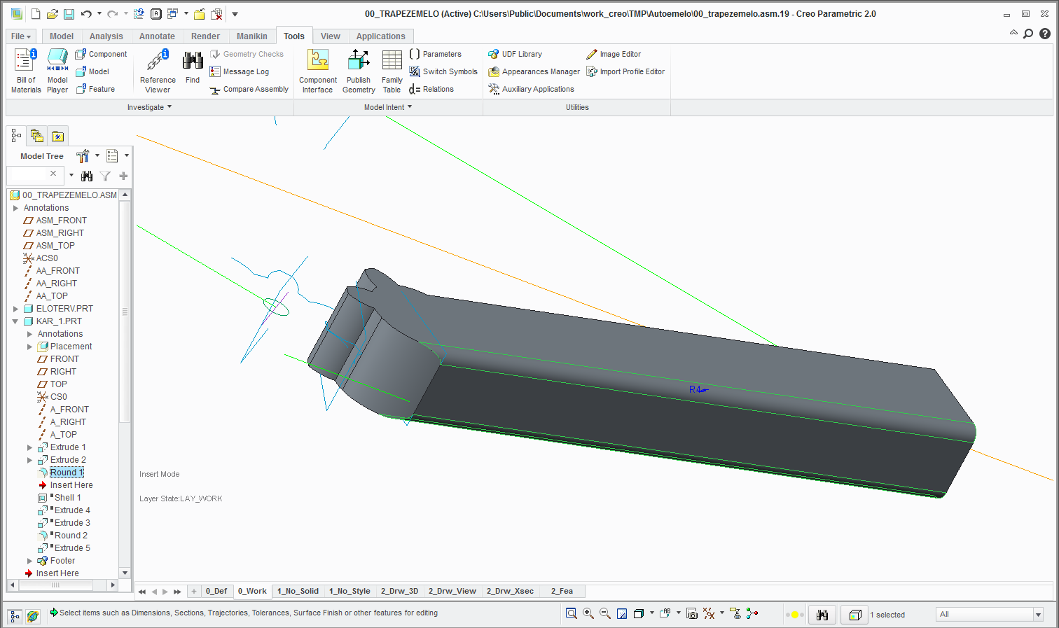

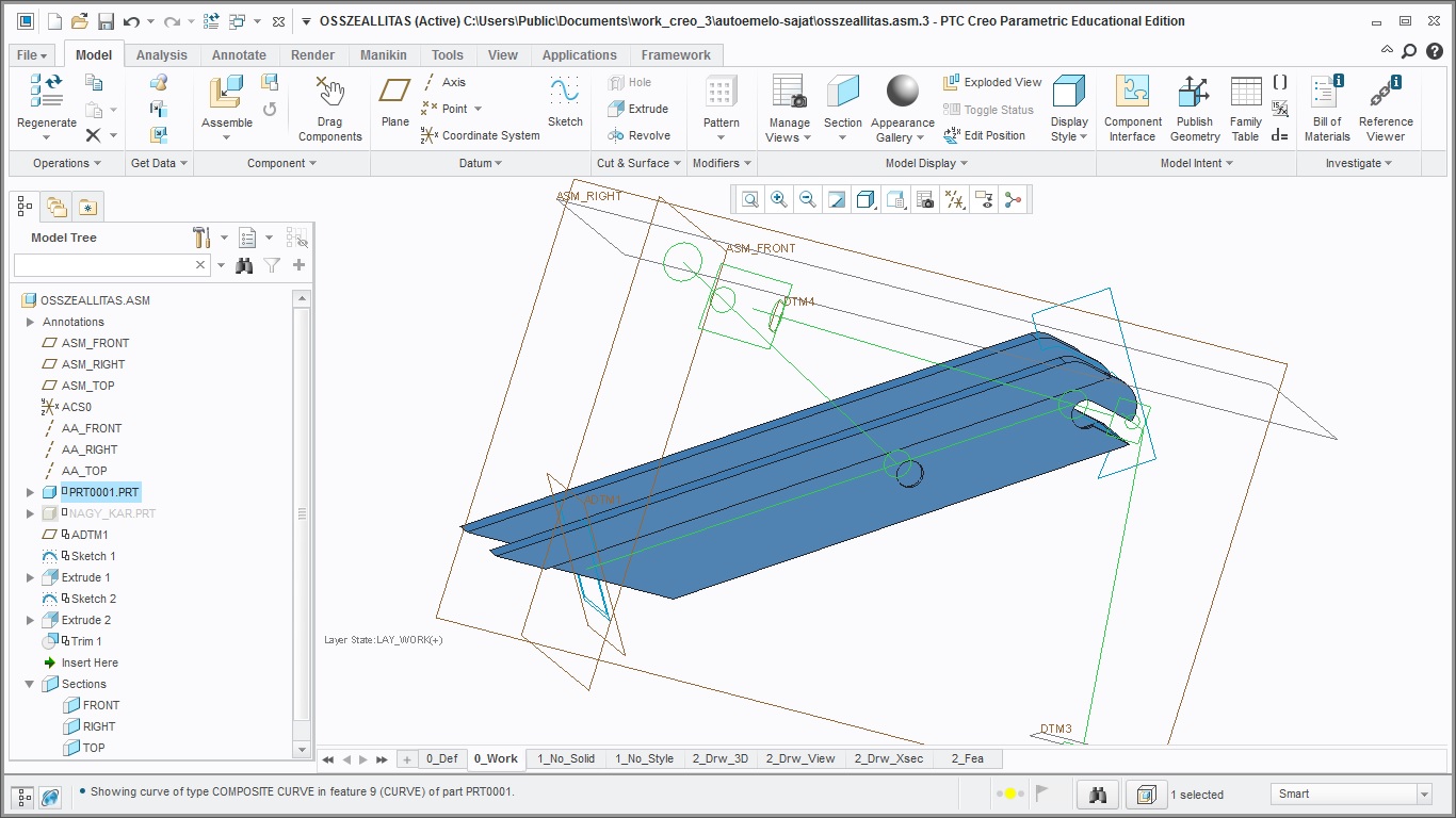

I was following a tutorial on modeling a car jack.
I think i did exactly like there :
1. Create a .prt where I make a simple sketch for every carjack part with the correct base dimensions, lenght etc.
2. Create assembly, add this sketch to it
3. Create new components for every part in assembly mode using the lines from that sketch
In there somehow he managed to extrude as solid.
So my question : Now that I have created that sketch, how should I create parts in the assembly using those lines as lenght, dimensions reference?
-For every part I should make a new sketch first, project the lines from the "helping sketch" to get those dimensions, than open the part's .prt separately, and there I should edit it, extrude as solid?
How would you do it? Please write step-by-step how should I open the part's .prt separately
Tutorial's pictures:
Here's how mine looks : ( mine is surface extrude, hollow through)
Thanks! (sorry for the english)

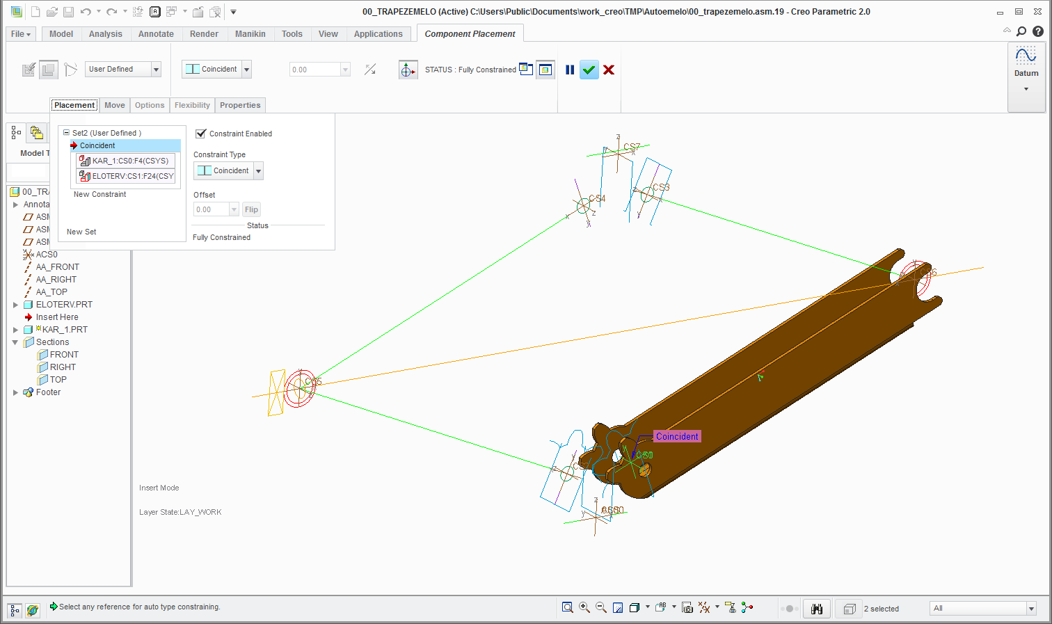

pkristof1-VisitorAuthor
October 10, 2015
Edit : Well i figured out a way, no need for more help:)
(I just copyed the whole "helping" sketch, made new part from it, than added itt to the assembly, where there's the original sketch so i can assure the part's good placement. so I copy that sketch for every new part
Thanks again
