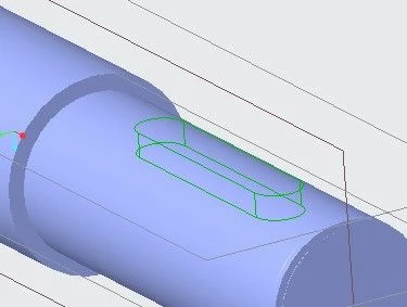

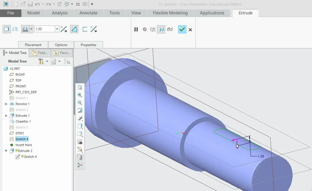

 I have a problem with removing material in Creo Parametric 4.0.
The plane on which the sketch is located is tangent to the cylindrical surface below.
When I press OK, nothing happens. I have a similar problem with revolving.
Best answer by TomD.inPDX
Change your extrude type to surface.  It is set to solid and it has nothing solid to subtract from.

My first inclination is there is a accuracy problem that prevents Creo from identifying an intersection. The easy fix is to make the cut bi-directional so that the cut starts outside the part by a small amount.
I am curious about why there are extra edges at the end of the part; there should be one circle, but I see two more white edges.
Is it possible that when you revolved the feature you created a surface?
vlaki111-VisitorAuthor
March 7, 2018
Yes, I revolved it as surface.
Thanks a bunch!
March 7, 2018
