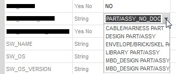

November 21, 2013
See attached image.
November 21, 2013
Yes. I want to have a parameter that has a known set of possible answers to have a drop down instead of having users manually typing them in.

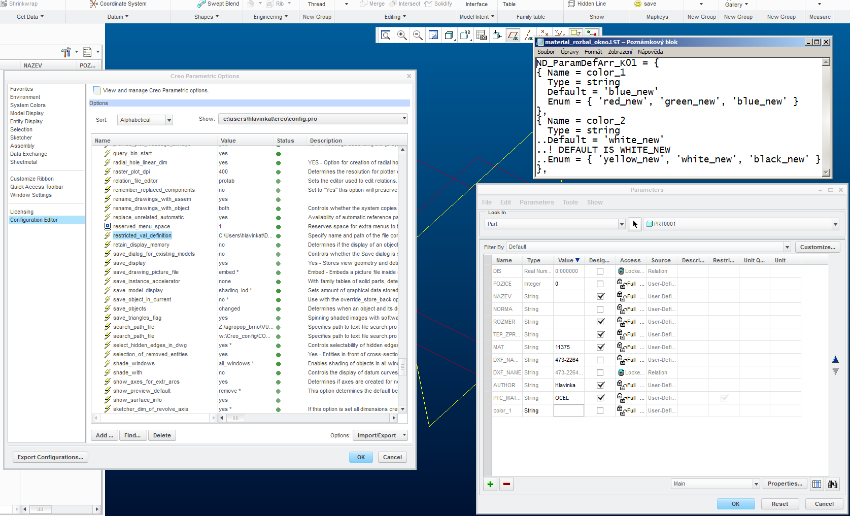

Hi Jose,
I tried to make two parameters with drop down list and modified the config.pro.
Unfortunatelly i cannot get it working.
Please see attached pic.
Thanks in advance
June 29, 2015
Tomas,
I uploaded my test restriction file list1.lst packed in list1.zip. I tested it in Creo 2.0.
config.pro option
restricted_val_definition D:\users\mh\creo2_parametric\list1.lst
Martin Hanak

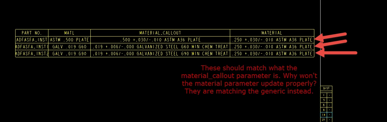

I am working on implementing this for our material callouts and have it working with the exception of within family tables.
With the generic I can select one of the materials from the table I built following this
Table-Restricted Parameters
However when I make a family table the only option available is the one from the generic. Is there a way to have all of  the materials in my table available for the instances?
I am replying back to this thread because it is far more recent than the other one specifically for using tables.
Edit
I can get the parameter matl to the family table, however the parameter material the is driven in the table will not update. If I open the instances they show the correct material. If I write a relation of material_callout=material it updates correctly. What is going wrong. I have attached my parameter file and a screen show of the family table.
