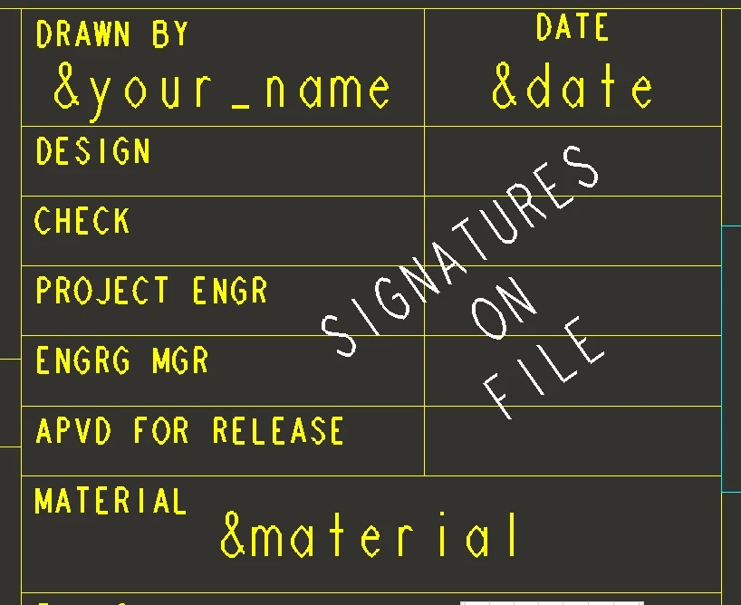

Is there a way to edit a format on an existing drawing?  I have a new format where in the signoff block, we have "Signatures On File" instead of filling in every name.  However, this is for any new drawings going forward.
We also have a lot of drawings that were originally pencil drawings or done in other software that we will have to eventually recreate in Creo.  I'd like to have the option to fill in the information in these boxes if necessary.  I know I can replace the format with another but I don't want to have two formats (one with the "Signatures On File" note and one without) if I don't have to.

It depends how the content is created on the format.  Tables are copied from the format to the drawing when the drawing is created (or when the format is applied).  This copied table can be altered and/or deleted independently in the drawing regardless of what exists in the format.  If the format is reapplied, the option is given to keep this modified table or replace it with a fresh copy from what currently exists in the format.
Everything else on a format other than tables (notes, symbols, sketched entities, etc.) are displayed in the drawing but are not copied to the drawing.  Think of the format like a transparency that lays on top of the drawing.  Any change to the format is immediately visible by any drawings that use it.
The white text you're showing looks like it's a note.  If so, it will not be editable in the drawing.  You can get around this by placing it in a table on the format (so it gets copied to the drawing) or completely leaving it off of the format and manually adding it as a note to each drawing (like Ben suggested.)
