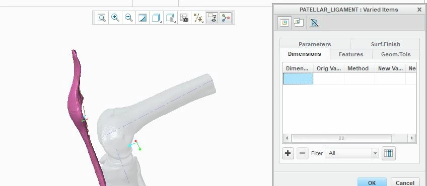

I want to attach ligament in a static assembly of knee joint. I have 3d scanned the ligament and transferred to creo. Now to bend it and attach to the bone I decided to make it flexible. But when I try to make it flexible I cannot choose any dimensions. Kindly tell me what am I doing wrong or suggest any other method through which I could bend the ligament and attach it to the required point ( I need to keep the length of ligament as it is). A picture of the scenario is given in the attachment.
Thank you for your help in advance.

Make flexible <> plastic deformation.
You might try a spinal bend. http://support.ptc.com/help/creo/creo_pma/usascii/#page/part_modeling%2Fpart_modeling%2Fpart_five_sub%2FAbout_Spinal_Bends.html%23
This is only an approximation and doesn't represent deformation that will actually happen. I don't know if it applies to scanned data.

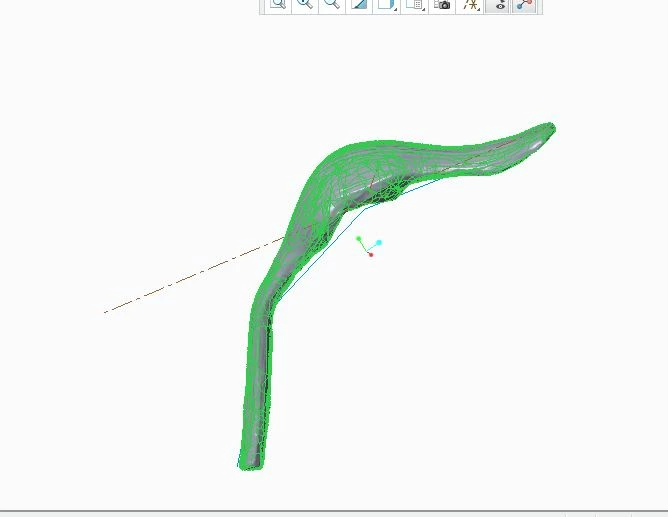

Thanks for your reply. Spinal bend worked.
