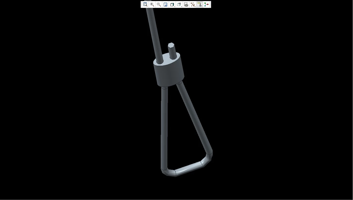

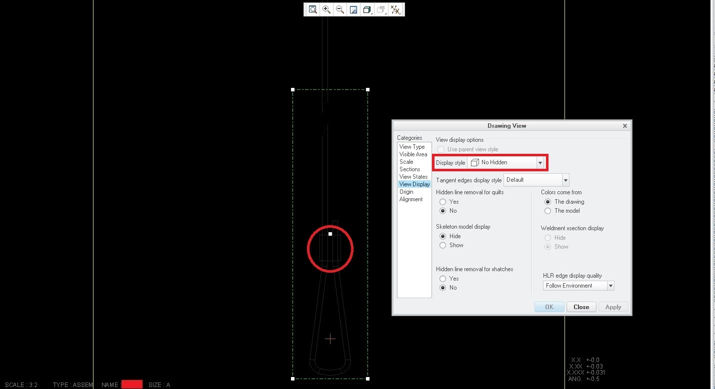

I'm currently working on creating a drawing for an assembly. As you can see in drawing mode, I've selected "No Hidden" as the display style. However, the wire still shows through the sheath in drawing mode (refer to the red circle in the picture below.) I've also attached a picture of the assembly in 3D mode to give an idea of the geometry. As you can see, the clip completely surrounds the wire. How do I prevent the drawing from showing what is inside of the sheath? I am using Creo 2.0.
Best answer by Mahesh_Sharma
Wiliam,
Tried a quick test on file and issue seems to be due to accuracy of part wire__.prt. I set the relative accuracy of part wire__.prt to 0.001 and this corrected the view display.

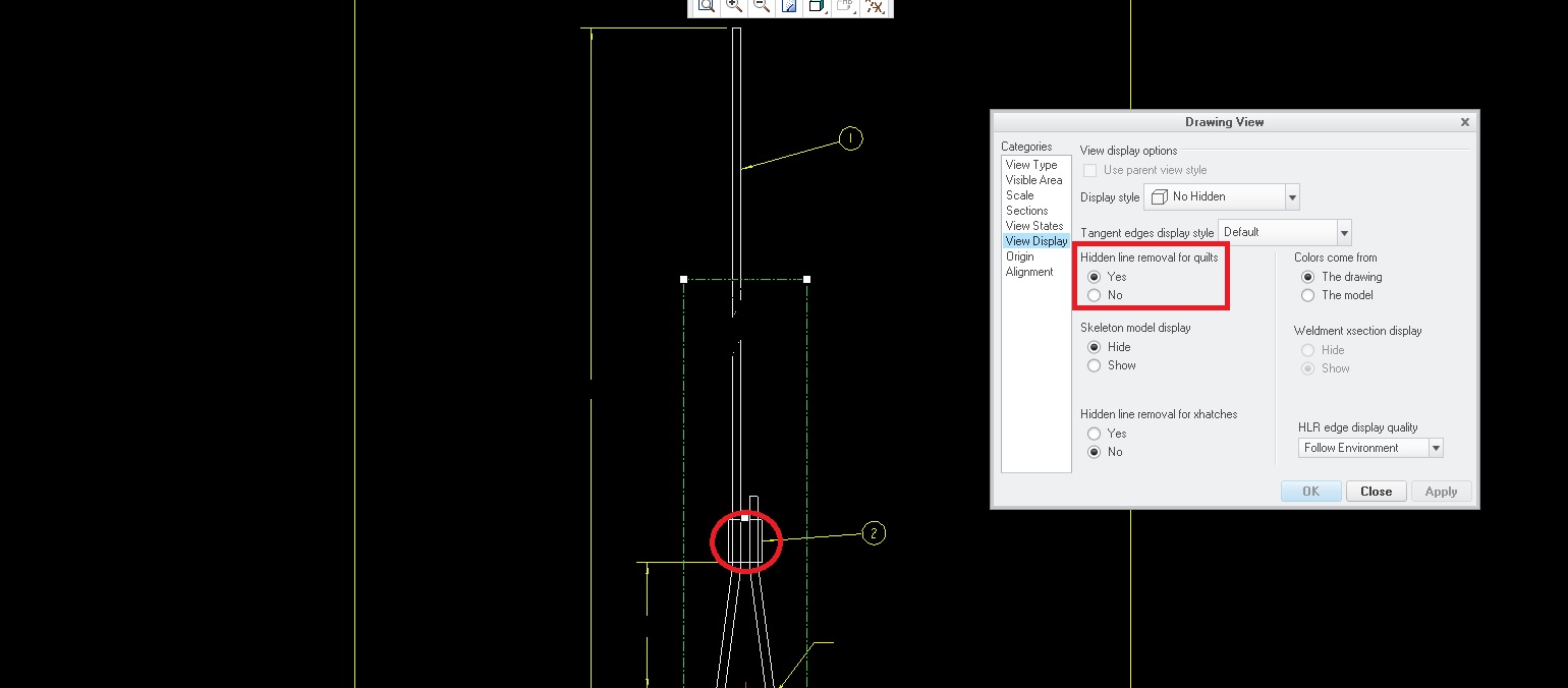

wjamieson1-VisitorAuthor
February 4, 2015
Thanks for the suggestions. I have changed "Hidden line removal for quilts" to "Yes" in the drawing view dialog box, as shown in attached picture. This did not correct the issue. Are there any other suggestions anyone might have? Thanks!
