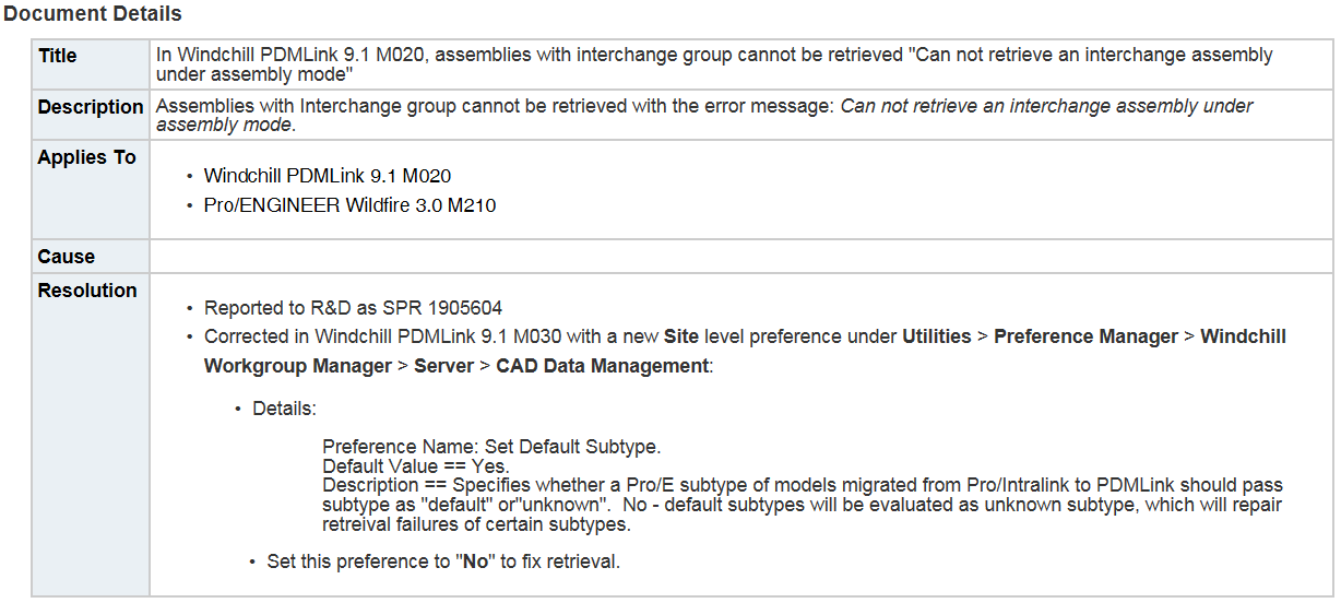

Has anyone seen this error??
Best answer by MartinHanak
I have found https://support.ptc.com/appserver/cs/view/solution.jsp?n=CS1115 document reporting the same error message
MH
January 19, 2016
I tested creation of new interchange assembly. Creo enables me to do this action only in case that Creo licence contains ASSEMBLY module. I hope that this is the source of your problem.
MH

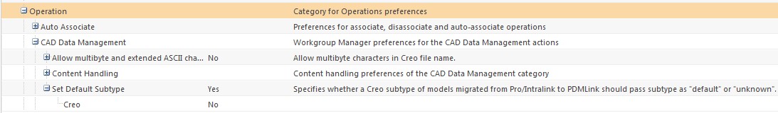

gwelk1-VisitorAuthor
January 20, 2016
Martin, Even though i am on Windchill 10.1 M40 and Creo 3.0 M50, this seemed to fix the issue. The only difference is the path to get there.
You have to go to SITE, Utilities, Preference Management, OPERATION, Set Default Subtype.....
I did not change the Set Default Subtype to NO, I only set the CREO line to NO and this worked.
So it is a little different in where to go to get there in Windchill 10.1, but the basic instuction works.
See below for path.... I appreciate the help...
