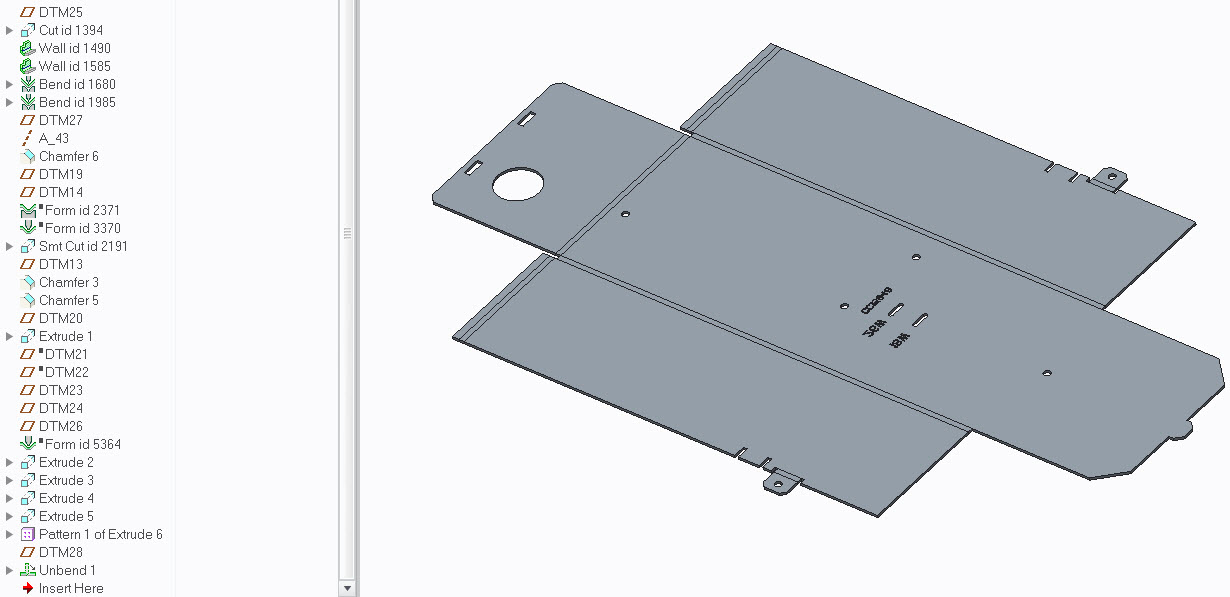

Help please! This model will not flat pattern or unbend. All radii seem to be constant and the part is fairly basic. Can anyone see what the problem is? I'm in creo elements/pro 5.0

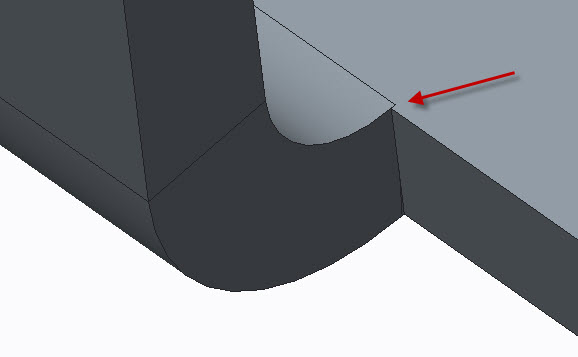

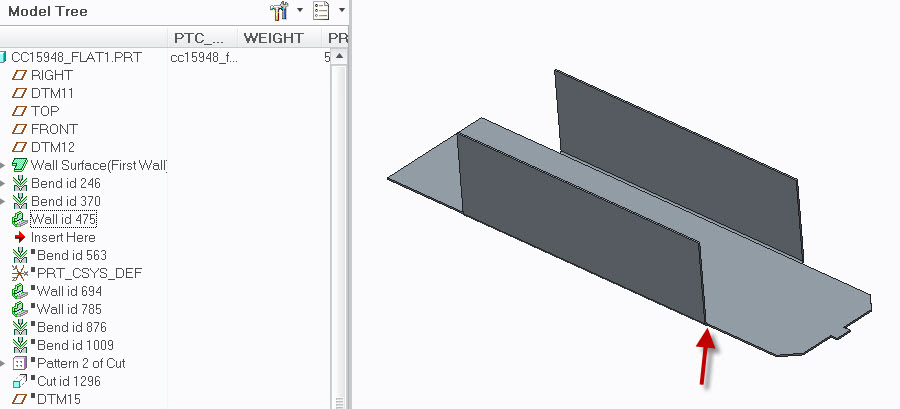

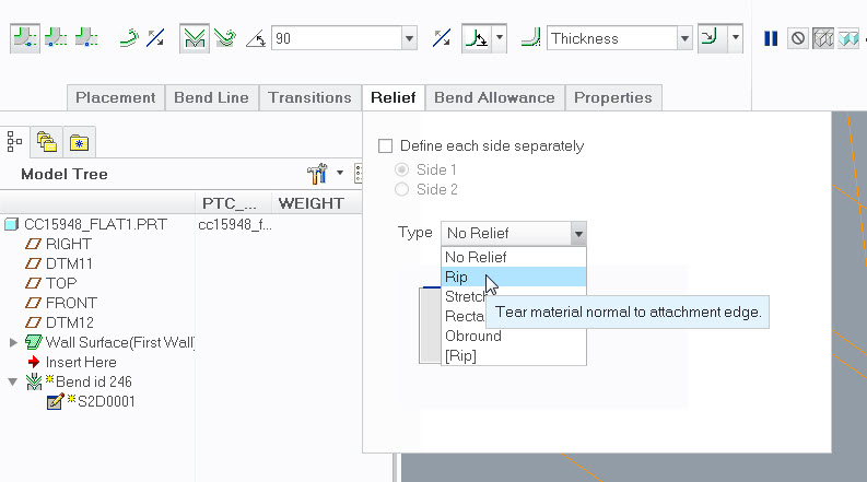

The problem is in your first two Bend features. The radius cuts slightly into the main bottom surface. You can either adjust the distance or create a Rip inside the Bend features.
I'm on Creo Parametric 2.0 so can only provide screenshot from this release. Note Form features are suppressed due to missing reference models.
