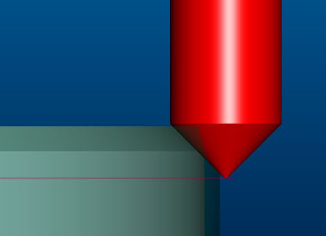

Guys,
I am working a lot with the chamfer option in Creo 3, which from my point of view is an easy one for most of my times I have to use it. However it happens a lot that i need to make a chamfer close to my vice and then a problem occurs! I can't find a way where i can control where on the chamfer mill I can use or position it. As you can see below it is rather close on the outside on the diameter, where when i am working close near the vice I'd rather would use it closer to the tip. For these purposes now i work around it with using a trajectory sequence where I have to sketch the path in a offset with an axis shift to get it working, which is a lot more effort .
Any thought?

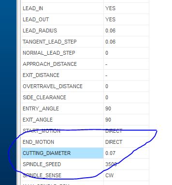

Paul,
there is also a parameter called cutting_diameter that allows you to specify the cut diameter that moves the cutter up and down.
Here is a before picture without changing the cutting diameter parameter..

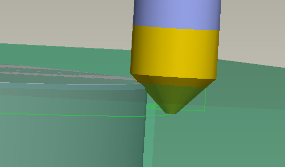

Parameter set to .07 (can be any number you choose) moved the cutter up.

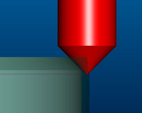

After the parameter is set there is only .07 below the chamfer edge.
So if you set this parameter to the length of the chamfer it will clear your vise.
