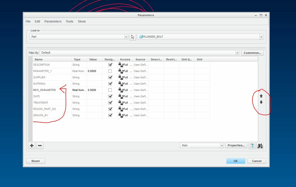

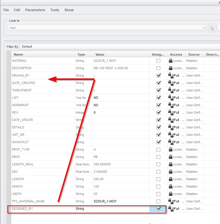

Hi guys,
I'm having some exsisting parts and assemblies in Creo3.0, these parts do have parameters. Now I'd like to create some new parameters in these parts. When I open the parameter-list, the existing parameters are sorted in the way they have been created. But now I'd like to put some parameters in between some existing parameters. Does anyone know how to do that, without deleting and recreating the existing parameters?
Best answer by John.Pryal
Hello, am i missing something here? If all you want to do is move up a newly created parameter then use the arrow keys at the right hand side. See attached image.

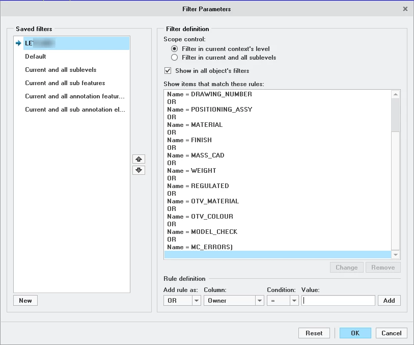

Instead of the default "Filter_By" create a new one and order to your own liking...
John
February 4, 2019
Hi John,
Great, I think that's the answer I was waiting for Smiley Happy
Thanks a lot. This will help me a lot!
