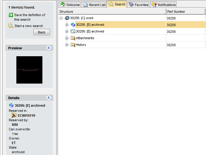

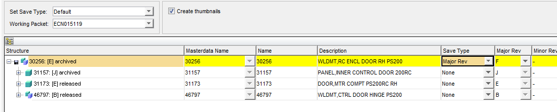

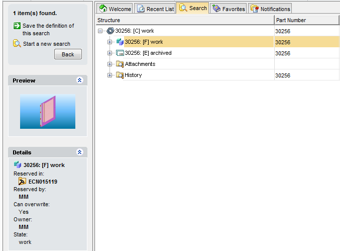

Hi Rober,
I'm not sure why you are unable to do it. It works for me.
I reserved the file to my packet, loaded the model file, and did a Major Rev save.
I'm now the owner of the new revision and it's in work state.
Mike
