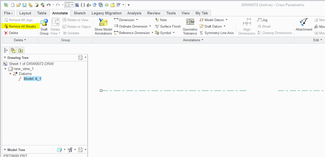

How do I take the breaks/clippings out of an axis that has been cut/clipped in a drawing in Creo 2.0?
Best answer by TomD.inPDX
You know what.... that is an excellent question. How do you remove breaks in shown annotation axes?
Aha! One would expect a RMB to reveal this.
February 19, 2015
