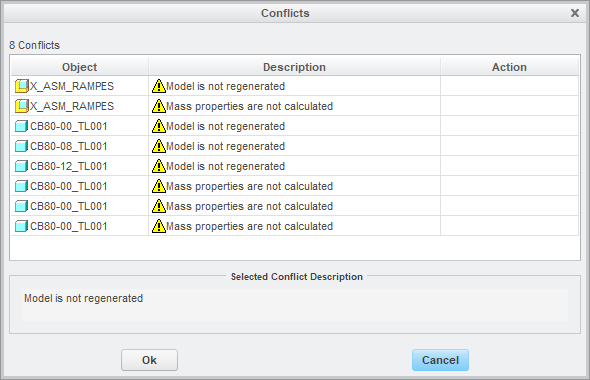

Hi all,
I'm wondering if it would be possible to avoid this message I get each time I'm saving an assembly made of some family parts issued.
Any config.pro option to regenerate, mass calculating automatically ?
Or disable those messages ?
Best answer by dschenken
If a change is made to the generic then it's best to Verify the family table. Sometimes a model is built with relations so that the calculation of the relations causes the model to be flagged as non-regenerated. This is typically an error and should be fixed in the model.
There is a  VERIFY_ON_SAVE_BY_DEFAULT option.

I'm going to say something in mass properties is demanding an update on changes.
Search MP_ and MASS in the options fields of the config editor.  Something may click.
file/options/configuration editor/find...
Are these sheet metal parts by chance?

There are sheetmetal parts.
