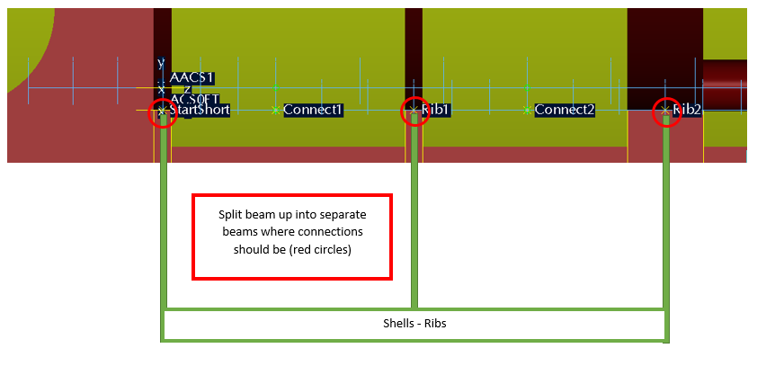

I am using Wildfire 4 and trying to create an assembly which is made of shells and beams. I am having trouble getting the two parts to attach.
Do I need to specify a connection (such as a Rigid Link) between 2 points on the respective parts?
When creating models with shells I have been able to align the components so the geometry automatically joins together but this approach does not seem to be working.

Cheers for the reply but I think I have just managed to fix it through various tests over the past few days. I've added a picture below and will explain it a little so it's here for others if they need help one day.
I have a series of vertical shells which are circumferential ribs in a structure. Going across the top of these ribs are 2 beams which go axially down the length of the structure.
To get the bottom beam to connect to the shell I had to make sure I split the beam up into sections where I desired connections (red circles, point names StartShort, Rib1, Rib2).
Initially I just made one long beam and it connected at the start & end, but modal analysis results showed it was not connected at the ribs and the typical 1st, 2nd.. mode shapes were seen.
