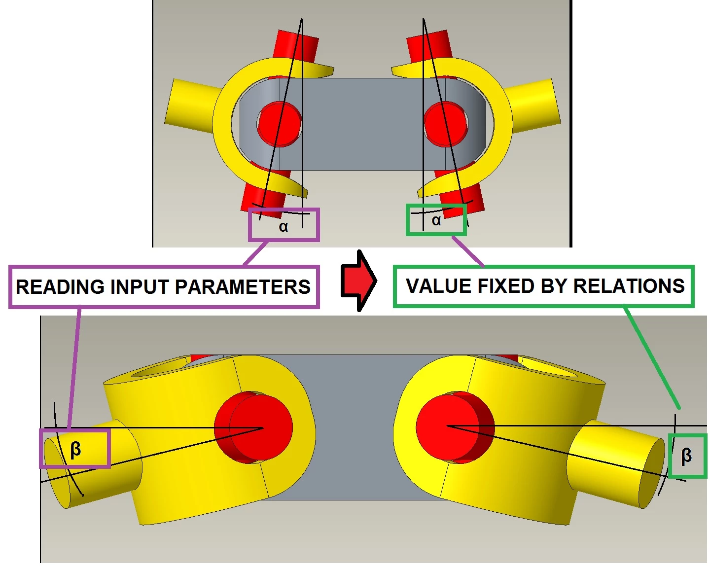

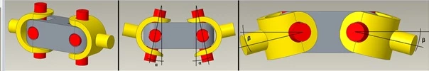

The model I want to create can be simplified considering it as two joints in a row, but imposing some constrains to their angles.
As you can see in the pictures below, turning angles of red crosses must be equal all the time. In the same way, turning angles of yellow hitches must be equal as well.
[PHOTO_1.jpg]
I want to implement that constrains so that I can include the component in a driveline and perform kinematic analysis on it.
I tried to do it in two different ways:
 1. I created two input parameters, reading "alfa" and "beta" in the first joke. Then, I created a relationship stating that "alfa" and "beta" in the second joke are equal to the input parameters values.
[PHOTO_2.jpg]
This way gives me two problems. The first one is that just the input angles are free when I drag the components, and the output ones are chosen once I regenerate the model.
Not only that, every time I regenerate, the "reading input parameters" change. So, I need to regenerate many times until output and input parameters are more or less equal...
That method is not either smart or accurate, and I think I could do it better.

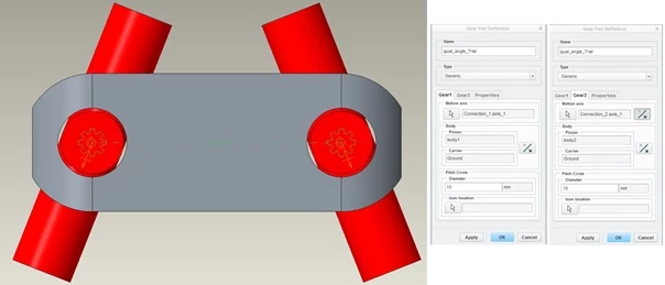

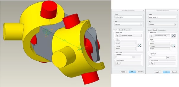

2. I used the constrain "Gears"
It worked fine in order to constrain the two red corsses, and it looks exactly what I wanted to get. See constrain details attached.
[PHOTO_3.jpg]

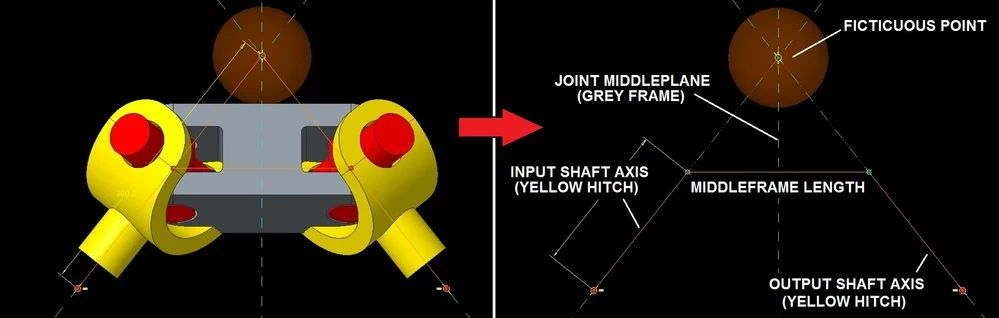

But the problem came up when I constrained the yellow hitches. It worked, but the I lost the first constrain, the one constraining the red crosses... and I cannot move them anymore.
[PHOTO_4.jpg]

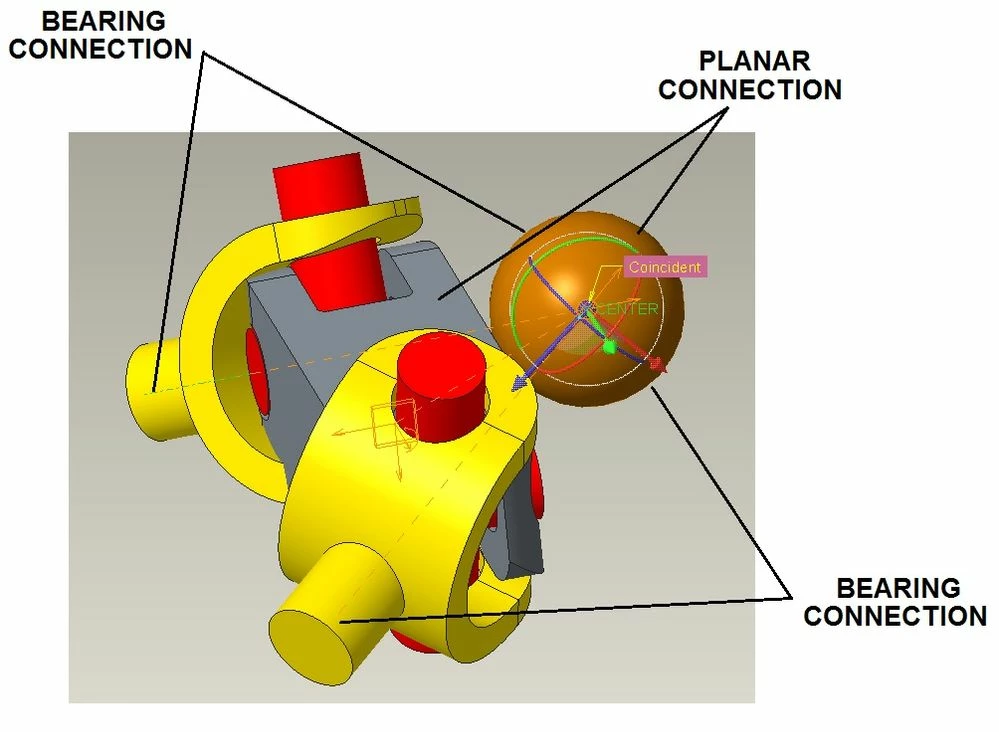

The real component I wanted to model is a Constant Velocity (CV) joint. Confidentiality wise, I did not want to show the real 3D model.
In order to get the desider result I added an extra component, which needs to be no more that a point and a plane containing that point. In the pictures I also drew a transparent sphere to make the point visible.
In order to fulfil the conditions requested in the first post, the axis of the input and output shafts must match always in a point contained in the middle plane of the grey bracket.
In order to get that, I constrained the new component (orange sphere) using 3 different set of constrains:
     1. Bearing constrain forcing the ficticious point to be located along the input shaft axis.
     2. Bearing constrain forcing the ficticious point to be located along the output shaft axis.
     3. Planar constrain forcing the ficticious point to belong to the grey frame middleplane.
Now, the goal constrains regarding angles are reached in both the current assembly and bigger ones.
