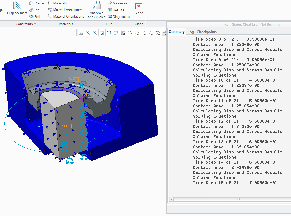

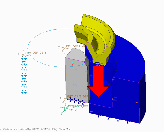

I'm trying to simulate the insertion of a metal "y"seal (yellow) into a gland (blue) to seal around a rod (metallic color). I'm a seasoned FEA user, but this is just past the edges of what I've done before, so I'm working out how to do it correctly. I want to see if this can be done in Creo 3.0. I thought I'd post the question to see if someone more knowledgeable than myself can provide some insight on what I'm doing wrong.
I've started with a 2D axisymmetric analysis, shown below, and plan on doing a 3D model as a slice. The basic details are;
-Rod and gland are fixed in X & Y
-Y-seal is fixed in X, fixed displacement in Y direction of 0.15 in. to make it land in the bottom of the gland.
-Basic mat'l properties for now, steel rod and Y-seal, SS gland.
-Contact analysis defined for edges (since its 2D axisymm) that come in contact, finite friction, mu=0.2.
-Nonlinear analysis, 10 equal steps to show some resolution.

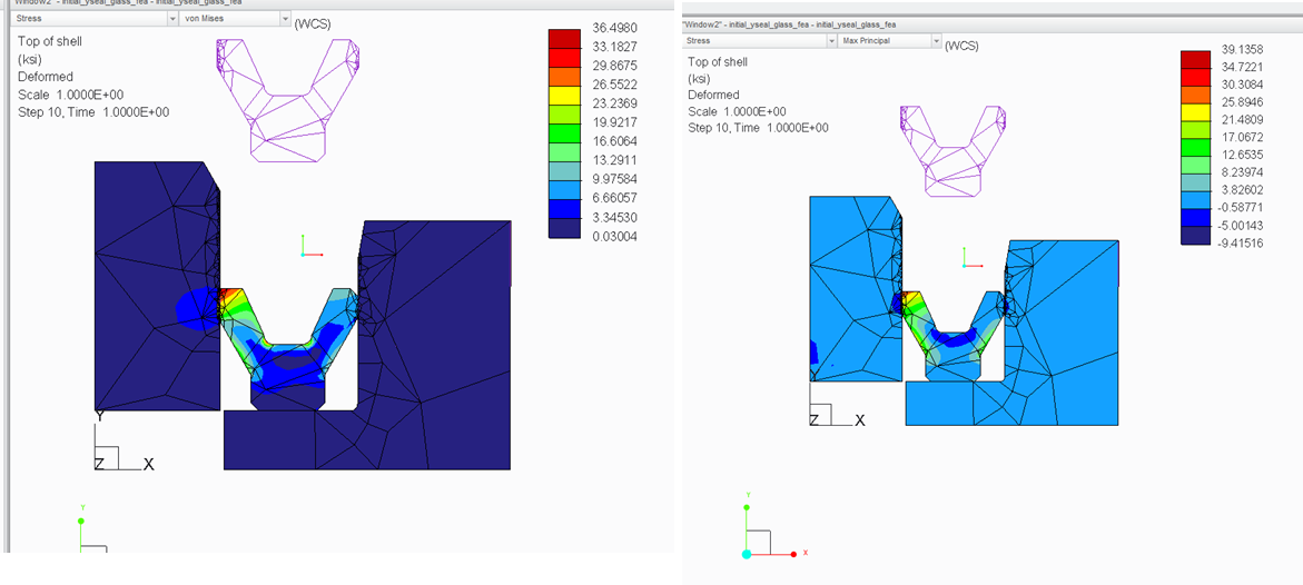

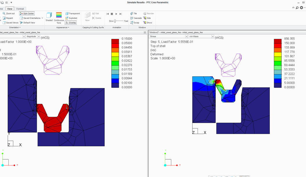

-Model runs in ~10 min, SPA, initial mesh for pass 1 is chunky but I let it do some automatic mesh refinement on pass 2 and it looks pretty detailed where its needed.
The 2D model runs and shows results somewhat like I'd expect. I expect to see the edge of the y-seal ride up on the gland and rod and NOT penetrate them. I do see some movement of the y-seal arms as it contacts, but it does penetrate the two other parts slightly. I'm not sure why it does this, but it makes me think I'm missing something.There are enough nodes in pass 2 that its not simply element passing thru element without nodal contact.
I've attached a zip file of the parts used in the assembly. Does anyone have any ideas/suggestions? Am I asking to much of Creo, or just myself?
