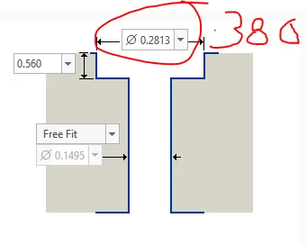

Counterbore change dimension when going between free & close fit after manually entering value
A current design needs a counterbore clearance for a socket wrench. I entered the value and then switched from close fit to free fit. The counterbore changed back to the standard diameter. Having manually entered this, it shouldn't change. I am glad I caught it. Here is a product suggestion filled out about this:

That's a huge gaffe.  I tend to avoid the "hole" command for this reason, unless I can't help it.  It's nice to have a "standard" table, but we need to have the standard table, and the ability to have other, standard company tables, AND we need to be able to override ANY value.
Wonder if there's a setting buried somewhere....?

The dimensions are still changing in Creo 9.0.4.0.
Clearance hole for a magnet with a clearance hole beyond that for a screw.
Change the screw clearance hole from a close fit to a free fit and my diameter of the counterbore change from the value I had already typed for the magnet.
