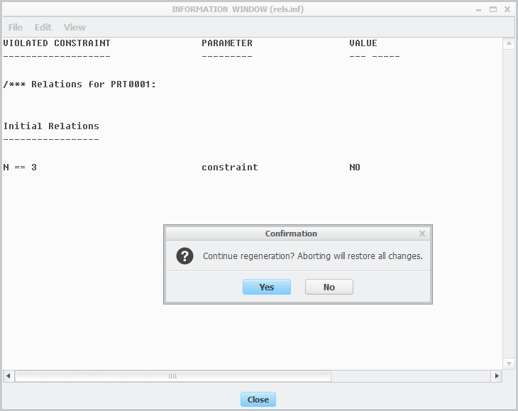

Is it possible to have an error message window pop up in a regen? I'm creating a drawing that takes user inputs and updates an assembly/drawing, but I want to have some built in failsafe so if the part does not fall within my program that it will tell the user.
2-Explorer
December 8, 2015
I'm not sure if this will do what you want, but it's an idea.  You can add a standalone conditional statement that "asserts" that something is true; when violated, you'll get a popup.  For example, say we set N to 2 in the relations.  Then we assert that it's value is equal to 3.
When you regenerate, you'll see something like this:
Other than that, I'm not sure if you can do a popup without doing some Toolkit or J-Link programming.
