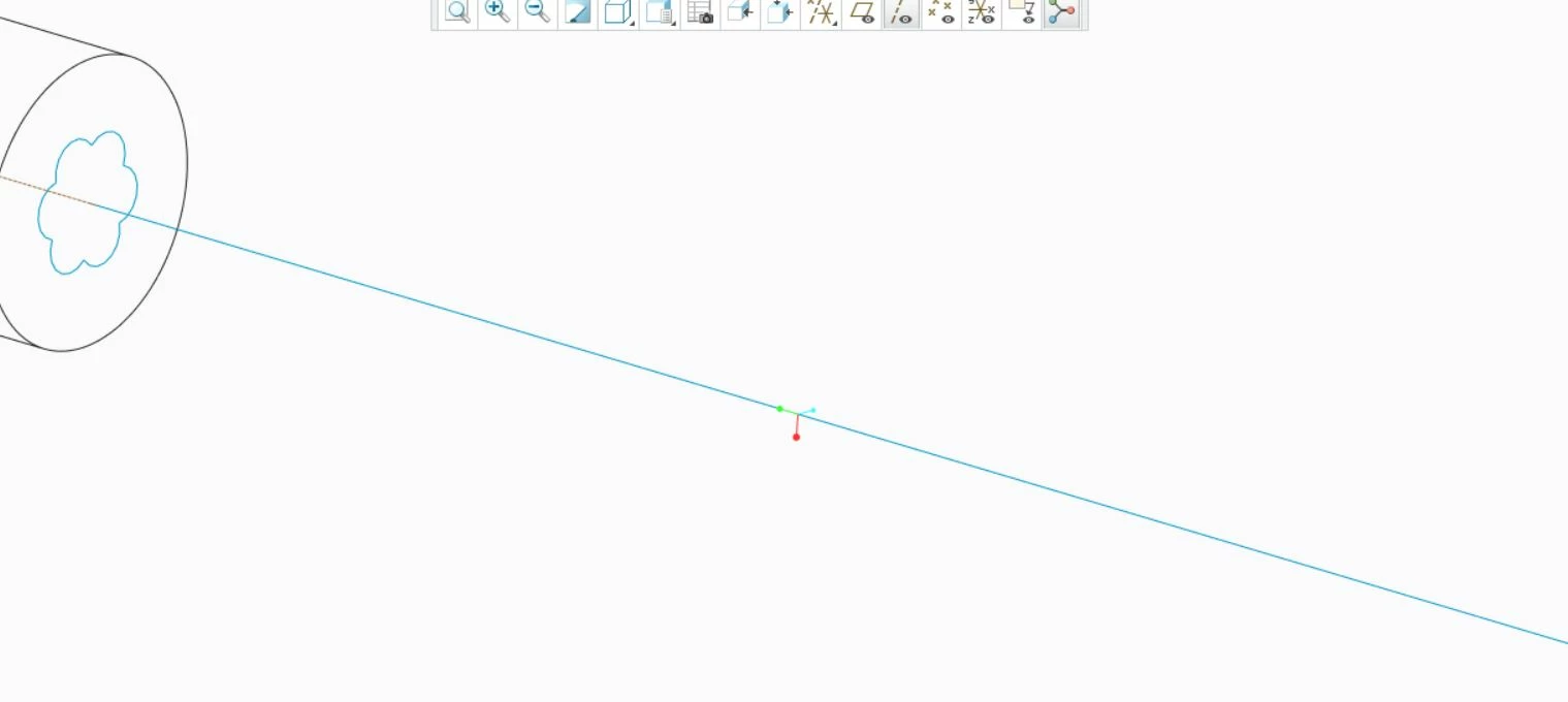

i have a profile like i have in the image.
i need to twist the profile fro 2 rotations , (360*2) along the path for 100 mm ..
can any one suggest an easy way to do this...
Blend is one option, but when i tried i could not rotate more than 360deg (one rotation) ..
kindly help if possible
Thanks in advance..

Hi, hopefully the attached model will help you achieve your goal.
Good luck!
John

There are a few ways this could be achieved. By relation using trapar or using 'Warp' feature with twist. I have attached a basic model showing technique. Good luck!
John

Thank you for the model, it was helpful.
however i thick sweep using relation would give perfect results than warp.
i tried to form a relation with the angle and trajpar, but i couldn't get the desired result.
if possible, can you help me with a relation.,..,?
Thanks for your help .. .

Blend could work if you add intermediate sections...added an example part.
