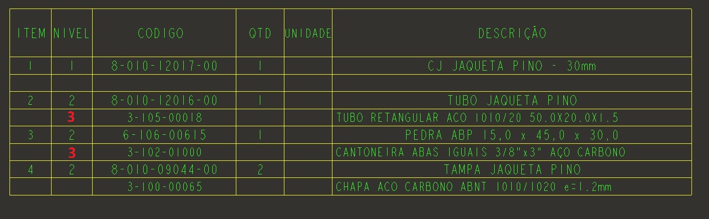

Hello.
I'm trying to create a table in 2D drawing where it should appear the level of assemblies and materials.
Ex.
Item level code description
1 1 033 assembly
2 2 044 piece
3 3 055 sheet steel 3.0mm
I can not find the correct parameter for this problem.

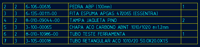

My guess of Repeat region parameters:
1st column ... &rpt.qty
2nd column ... &rpt.level
3rd column ... &asm.mbr.code_param
4th column ... &asm.mbr.desc_param
MH

To put - & rpt.level
It does not conform to the image it sends it repeats the top level of the table.
I want the level to conform to the image. Piece level 2 and material level 3.
April 25, 2017
maybe repeat region attributes are not set properly.
MH
April 25, 2017
Or repeat region is not defined properly. Try to create single line repeat region.
