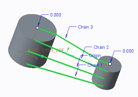

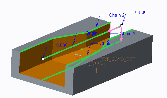

I have tried several times to produce a sweep that has multiple chains within the sweep command and have been successful.
As shown by the following image:

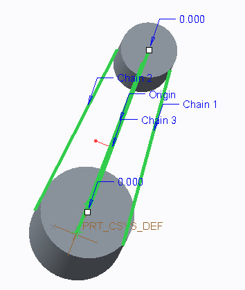

When trying to create the same type of sweep using two cylinders, one extruded higher than the other but both extruded from the same datum plane, I cannot get it to work.
See next image.

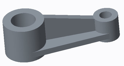

This is what I am trying to achieve. See next image
Any help would be appreciated.

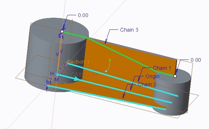

Best answer by dschenken
Imagine there is a plane that is perpendicular to each point along the origin trajectory. That plane needs to intersect the additional trajectory chains. In this part, where the large cylinder is, the additional trajectory chains do not cross or lie on the plane for the initial start point.
Change the primary trajectory to be coplanar with the start points of Chain 1 and Chain 2 trajectories.
dschenken1-VisitorAnswer
March 4, 2015

dprobst1-VisitorAuthor
March 4, 2015
Hi David,
I did place all starting points on the same plane and made sure the ending points were also the same, but it still will not sweep correctly.
I have attached another image of what I get. I will says this much. If I draw a straight line from point to point on the bottom and then draw an arc (from each point) from the end of the line to the point at the top, it will sweep with no problem.
Just to clarify, I am trying to sweep a "Tee" cross section.

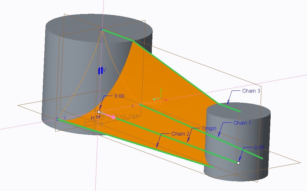

Here is the same part but with a different cross section and it sweeps fine.
