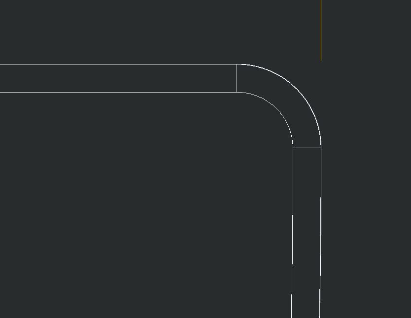

I need to create a horizontal drawing dim between two arcs.  Because of draft, I need to zoom in tight to each arc to be sure I'm getting the outermost line.  However, after I pick the second arc, the helpful Creo gnomes assume that I want a vertical dim instead of horizontal.  I tried the RMB options before placing the dim, but horizontal isn't a choice, only vertical, perpendicular to and parallel to.
I tried clicking on the little horizontal icon on that dimension mini dashboard, but then the tangent was unselected.  So I selected tangent again, horizontal still showing, and tried again. Still got a vertical dim (that wasn't actually tangent either, yay!)  I tried just picking the horizontal button, then Creo won't let me pick anything but vertexes.  (Turns out that button is "Draw an imaginary horizontal line through the specified point."
How do I get a horizontal dim between, and tangent to, these arcs?

In other dims, I've noticed that Creo will highlight it as horizontal or vertical, depending on where you position your cursor before hitting MMB.  In this case, although clearly a horizontal dim is possible (and to the human eye, the only one you'd want), Creo refused to create one.
That made me think, perhaps there's not not a horizontal tangent to tangent solution here.  It turns out, that was the case.  On the one end, the arc is tangent to another arc:
I was dimensioning to the small arc at the top, evidently the vertical tangent is just off of it, on the larger arc below.  I selected the larger arc, and the Creo gnomes smiled on me and created my horizontal dimension.

March 4, 2016
Well, I got my dim created by selecting parallel to and picking one of the default dims.  Not quite what I wanted and far to painful to get there, but it'll do.
If anyone has a tip for getting it to go horizontal, I'd love to know.
