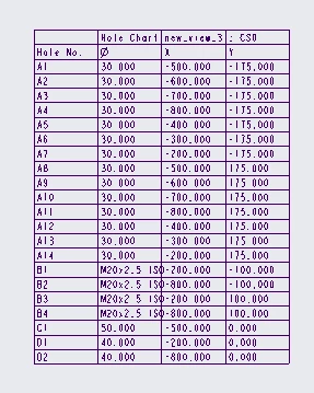

We are creating a hole table with Creo 1.0 M020 in the Drawing. The table is created successfully after we choose the coordinate system we want but the table only shows 10 holes and we have 36 in the model/drawing.
How do we get the hole table to show all the holes?
Best answer by DamianCastillo
The problem I was having was solved. We had holes created from different starting surfaces and this was not allowing the hole table to show all holes.
We had some holes we cut from the top surface down and another set that was cut from the bottom surface up. The holes must all be cut from the same "Reference" surface in order for the Hole Table to understand how to add them automatically.
Check and see if this is also your situation.
Made sense once we realized what we did wrong and how the Hole Table finds what to add to the list.

Hi
when you create a hole table
Please check the following
1.Include > cuts if you have made any extrude cut holes
2.Number of rows >No limit
If you still face problem, you can upload your part and we can check what is the problem

I am having a similar problem when I use the hole table. I am only getting 12 holes out of many holes in my table.
Can someone tell me what i am doing wrong. I am including the cuts, and the number of rows has been set to No Limit.
Dale

Dear Support,
Required Z-axis in hole table. It also includes X-Y-Diameter
Please help...
