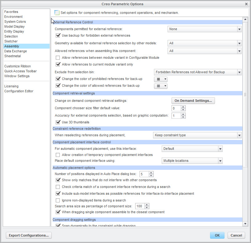

Jack,
Check your external reference settings. This may be preventing you from doing it in the assembly.
Hope this Helps,
Don Anderson
March 25, 2014
I don't have any restraints on external referencing in my settings, that I can see. Were you thinking of a specific option that might cause this problem?
March 25, 2014
Jack,
When you add a surface or volume region at the assembly level it will be stored in the part file but you should be able to define it at the assembly level.
Do any of the parts have features created with a module requiring a floating license?
See if your settings are are simalar to these below.
File > Options > Assesmbly >
Don

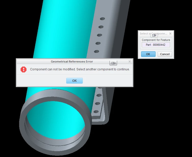

November 14, 2014
Hi All,
Im running into a similar issue. I have three parts (all Sheet metal). I can assign a surface region on one part, but the other two give me a "Geometrical Reference Error" and cannot proceed. I can add teh region to the parts individually, but not in the assembly.
Any ideas?
November 14, 2014
Paul,
Surface regions are stored in the part files, not in the assembly file. To avoid external references it's better to create the surface or volume regions in the part files.
Don
November 14, 2014
Hi Don,
Then why can I add it to one part, but not the other two? I'll assume it has somethign to do with adding eh reagion to eh first part, the grounded part, the 'default' constrained part.
