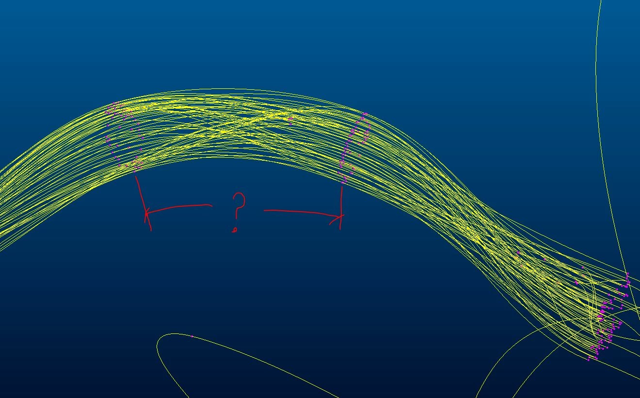

In WF you were able to get a partial length from one location to another. Where did our friends from PTC move this measurement capability.
I can only get the entire wire's length. I don't want the entire wire's length, I just want a portion from location A to location B.
Thank you
Best answer by NeilM
Hi Abel
If you use the Cable Length tool to select the wire that you want to get the length of a segment on, then select the two locations that you want to measure between the length of that portion of the wire will be displayed in the message log.

Neil's answer is correct.  However there are nuisances obtaining the length because you have to select the same cable location at each end of the bundle or it will not get
you the length.  It is cumbersome trying to find the same location among 50 or so locations in a bundle.
