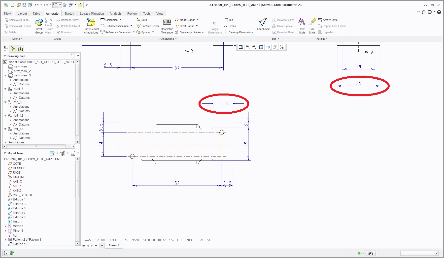

Hello, I would like to kwow how can i modify the CONFIG.PRO ----> to put dimension with text  "parallel to and above leader"  ??
Thank you.
Fabrice...

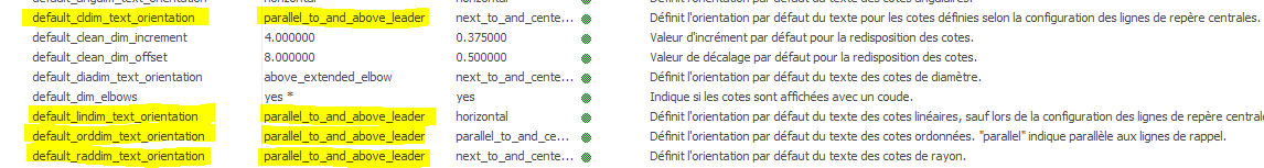

Bonjour,
Voici ce que j'ai :
9 replies
RaphMORIN16-PearlAnswer
March 6, 2017
Bonjour,
Voici ce que j'ai :

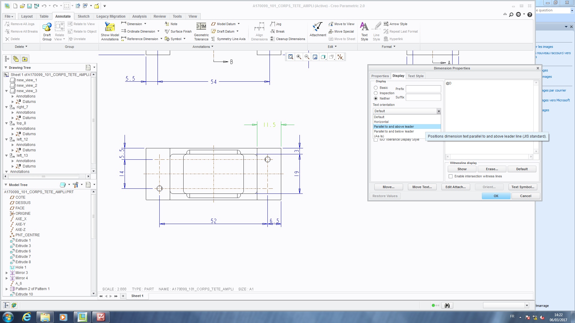

this property is not set directly in config.pro. It is set in drawing setup file. config.pro contains drawing_setup_file option which points to drawing setup file.

if you have prodetail.dtl file, you can edit it in Notepad/Notepad++//Wordpad. Then in config.pro define drawing_setup_file option which points to prodetail.dtl (enter full path to file). In this situation when you create new drawing, Creo copies the contents of prodetail.dtl file into the drawing. Later if you want to change settings in existing drawing, you click File > Prepare > Drawing Properties and then in Detail Options you click change and modify what you want.
