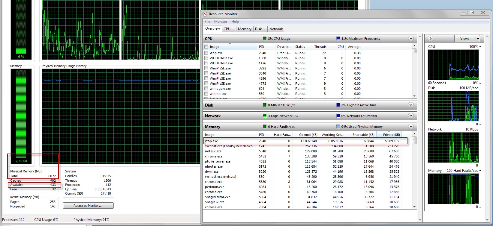

We made some tests and looks like when open complex assembly in Creo 2 several times work and then exit form Creo memory occupied stands on 1-2 GB more than before using Creo. It is looks like Creo doesn't release memory correctly. It can be very dangerous, since several restarts of Creo can exhaust memory resources even you have plenty of memory.

were seeing this with Windchill M070 and Creo 2 m020
Lots of users complaining about creo crashes after loading large models
and then thinking they have removed from session, open another assy and
bang away goes creo
