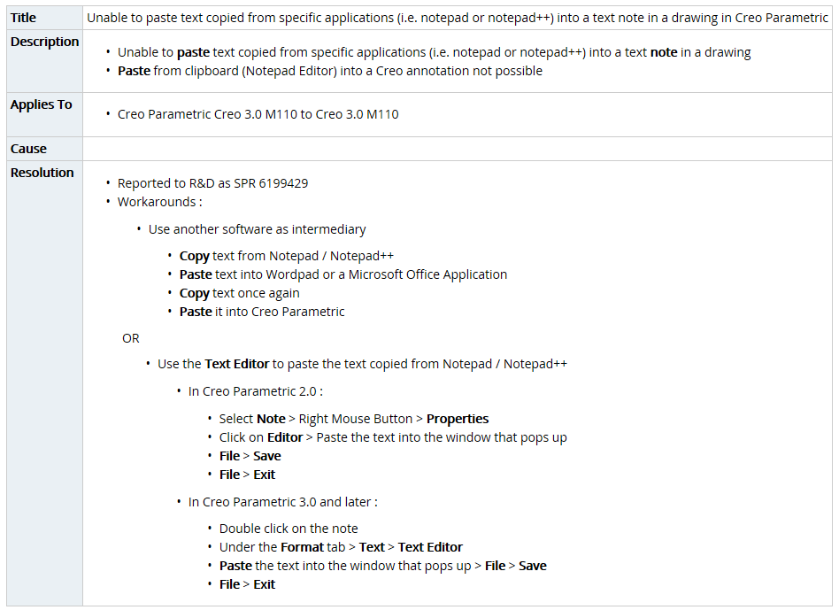

I've just installed the Creo 3.0 build m120...   and I noticed that the text copy&paste from Google Chrome, Notepad, Notepad++ to a drawing doesn't work ... I only can copy from Iexplorer and MS Word ...
The copy a text from the Creo lower dashbord also doesn't work .
The workaround is paste inside the format -> text editor
The build m100 works well, but the m110 have the same behavior as m120 ...
I'm running Creo on Windows 7
Any help would be appreciated ...
Regards
Best answer by TomU
This is a known issue.  No date for a fix is listed.
https://support.ptc.com/appserver/cs/view/solution.jsp?n=CS248355

hum... Ok, I concur, I see the same issue in Creo 3-m110.
specifically. I created a drawing empty no model, added a note and picked a placement location. Then tried Control-V to paste text I'd earlier copied using Control-C.
Didn't work with text copied from the message area, or Chrome. Did work with text copied from  IE.
If you type some text and then go to the properties for the note you can paste text into that dialog from any source.
This seems to be a very narrow case. The problem only seems to appear when you have placed a note on the drawing that has no text and are trying to use control-V to populate the note with the copied text.
April 12, 2017
That document now says it's fixed in Creo 3 M130 (due later this month) and Creo 4 M010 (already out).
